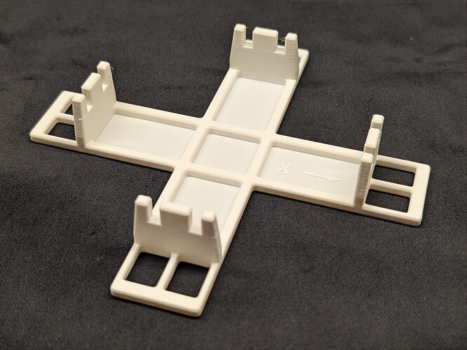

@PCR , just because you mentioned a 20x20x2 block for calibration: That sounds very similar to the ubiquitous calibration cube. In case that is what you use now, I want to encourage you to watch this excellent video:
Maybe you want to switch then to this calibration model and guide instead:
