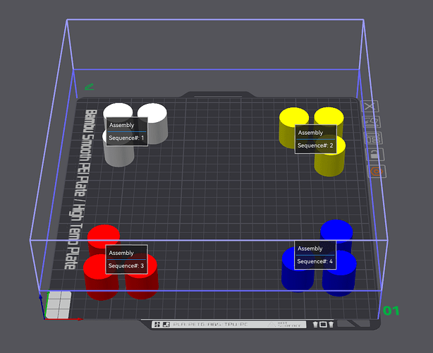

You can do this already. I have a post here explaining this for a very similar question but for the life of me I can’t find it so I’ll detail it again.
The trick to doing this is to “print by object” but “Merge/Assemble” the parts that are the same colour. This causes the slicer to print all the parts in one colour, then switch to a different colour to print the remaining parts and so on. It works quite well.
Oh that’s a handy trick! A little more manual than I wanted but I do this infrequently enough that a bit of manual grouping isn’t a big pain. Thanks!
