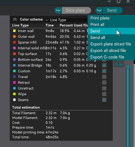

Hey @BambuLab or anyone else involved with Bambu Studio, I have one printer and find many times that I have multiple things to print and only one printer. I also only have one Micro SD card for my A1 Mini. I was wondering if y’all could make a feature in Bambu Studio under the “Print Plate” option to “Save File To Printer” so it would download but not print the file. I would find that it would be helpful. Let me know what y’all think!

That option already exists.
Click the down arrow, then Send.
Print plate will change to Send, which sends the g-code to the SDcard in the printer.
Perhaps you are referring to this feature that allows one to simply transmit or all the build plates to the printer?
For send, does it have to be on LAN? I always thought that send was the equivalent of Print Plate if you are on LAN only mode
Still works in cloud mode.
I always have to re-establish a connection to my printer when I try this. It is a real pain so I don’t try anymore.
If I can “print plate” via the cloud, I don’t understand why I cannot just “send” via the cloud.
