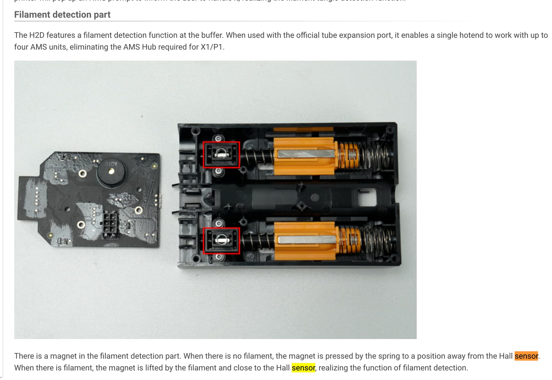

It should simply back off from the toolhead to the buffer, then stop at there.
Utilizing this sensor the AMS theoretically can retract the filament completely from the internal ptfe tubes and hold the filament at a safe zone.
@SupportAssistant please :pleading_face:
This sounds better.
I wasn’t sure if the buffer had filament sensors. Some other posts were giving other feedback on this.
Then it is definitely possible to define a state for that.

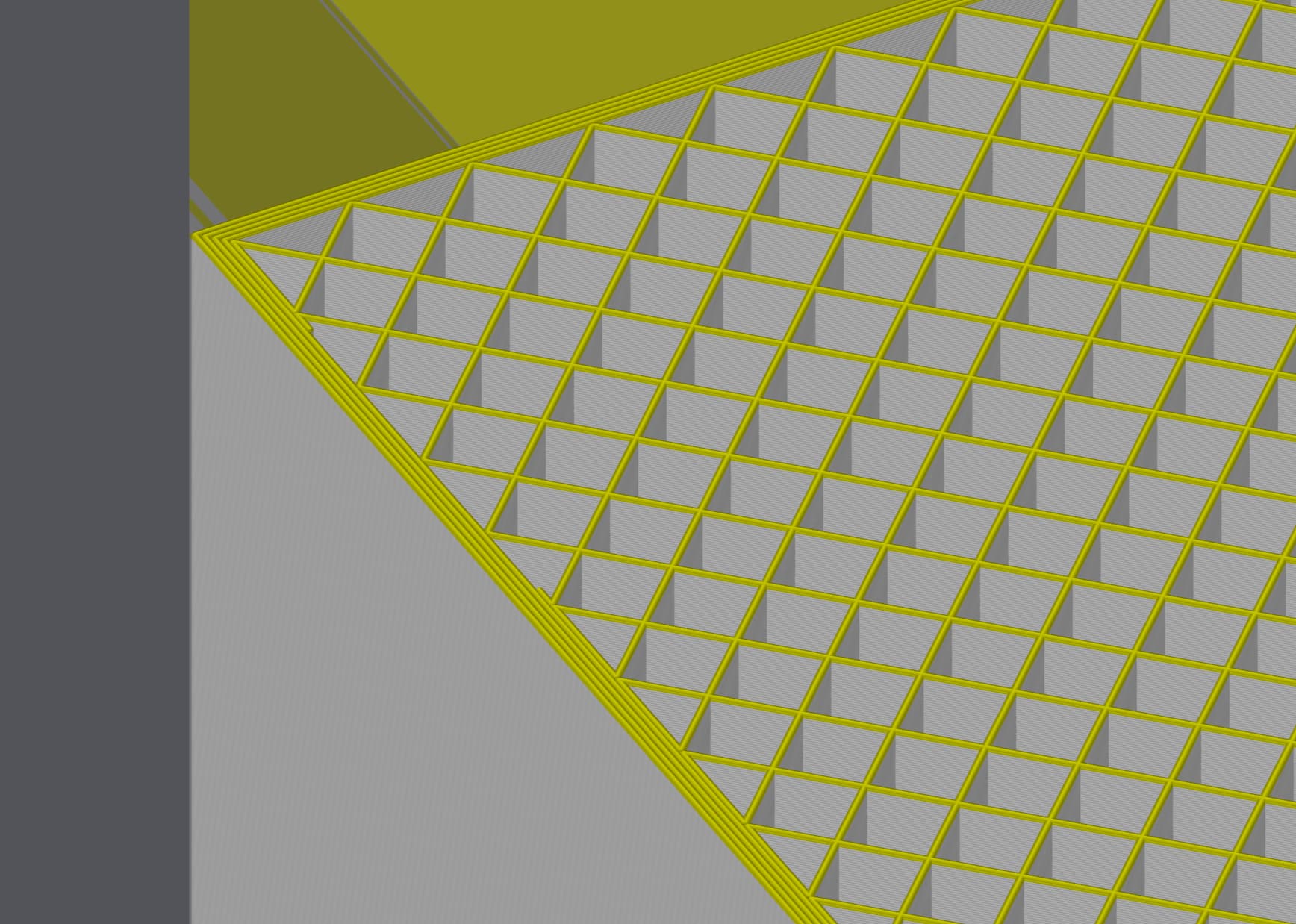

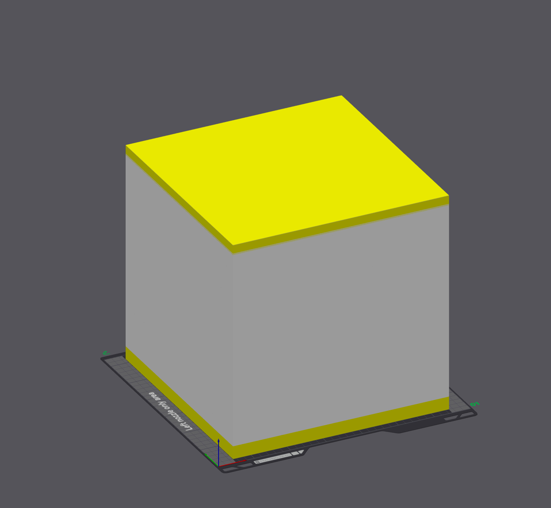

I had it happen with even just normal PLA, when printing a large part. Especially if the tool head is moving in a way that the ptfe tube has been repeatedly bent but no extrusion happens (so the bending strain would repeatedly damage the same spot for the filament in the left nozzle)
A theoretical case is, a 30cm x 30cm x 30cm solid cube, with ONLY the first and last layer using the left nozzle, and all other layers using just right nozzle. With something like this the yellow filament which stayed in the other extruder path is definitely gonna break :slight_smile:
In real world it doesn’t have to be a solid cube, but as long as there’s repeated bending without (at least some length of) extrusion in the left nozzle, then it would eventually break.
@hotellonely Thanks for clarifying this.
@SupportAssistant Here some additional info on top of the above.
This is exactly the case.
However in your use case, it might not go wrong, because the same filament is used again on the top. Big chance that the AMS will push the broken bits into the extruder and all goes well.
There are at least 2 scenarios possible:
  1. There is no 2nd color change at the top.
    The printer tries to unload the filament at the end of the print job. the broken bit is not removed, and the printers stops at the end of the print job during the unload with an error.
    Result: print job complete, but error at unload.
  2. The top layers require a different filament.
    In that scenario the AMS also tries to retract the filament, but now the print job cannot be completed because of the same error.
    Result: print job incomplete, and possible quality issues due to cooling or other effect due to the stall of the print.
