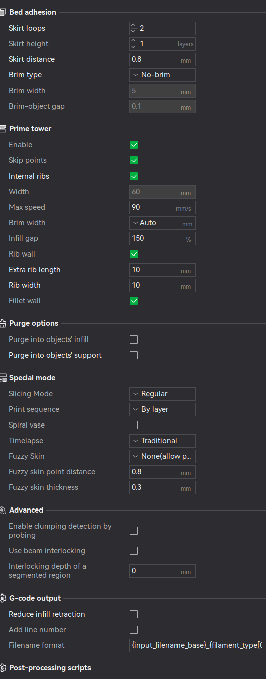

Reduce Infill Retraction is disabled.
avoid crossing walls is enabled but does not what it should (moving around the object instead of over it.)
