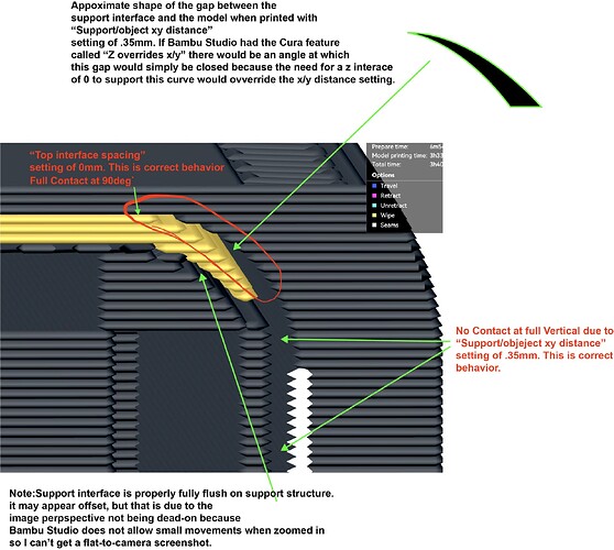

The problem is on the top steep part, not the lower part which is below 45deg. Cura has an option “Z overrides x/y.” for this exact case. it allows the support interface to actually touch the steep overhang even if it is within the horizontal separation distance. The problem is in the second example, the Bambu Studio example…where the yellow portion (the dissolvable support interface) does not actually touch the model as it must when we are getting up to 65-75-85 deg overhangs.

Hmm, that’s not what I see. I see the yellow layers to be touching the black layers above, which I assume is the model. The problem I see is that at the right end of the yellow layers they’re printed up in the air. The black layers below them, which I assume is the support body, are several layers down. So it seems that the support below the interface gets cut away due to X/Y distance and the yellow interface layers end up in mid-air.
Yeah, I can see my screenshot is not from an angle that is clear. The yellow does not touch model, and the interface layers are not printed in the air. When fully zoomed in, Bambu Studio does not allow smooth small-step rotation of the view, so it is quite difficult to get a good screenshot.

The need for the override setting is a known issue on all Cura/Slicr derivatives, and is the reason the “Z ovverrides X/Y” setting exists in Cura and in Prusa I believe. I have confirmed it on screen and in printing. The only solution I’ve found that works is to hand-model supports in CAD and then choose dif. filaments for them in Bambu…then do a ton of customizing of settings to get a ‘part’ to print like a support (interface layers, sparse internals, no walls, etc…).
Here is a better screenshot so that you can see how it actually prints in Bambu.
Without this setting available, soluble (and sometimes breakaway) support simply doesn’t work in many situations unless the entire support structure is printed in the separate support material. This is not practical with a single extruder and filament changes. Best practice requires using support interfaces in the soluble/breakaway material and the rest of the support structure in the original material. This doesn’t work though because the support body ends up touching the model. Only “Z overrides X/Y” fixes this issue by allowing the support body to keep a safe distance while at the same time allowing the interface layers to make full z contact with the model to be supported.
