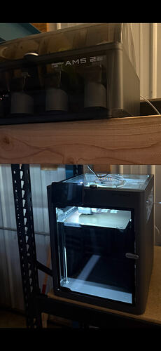

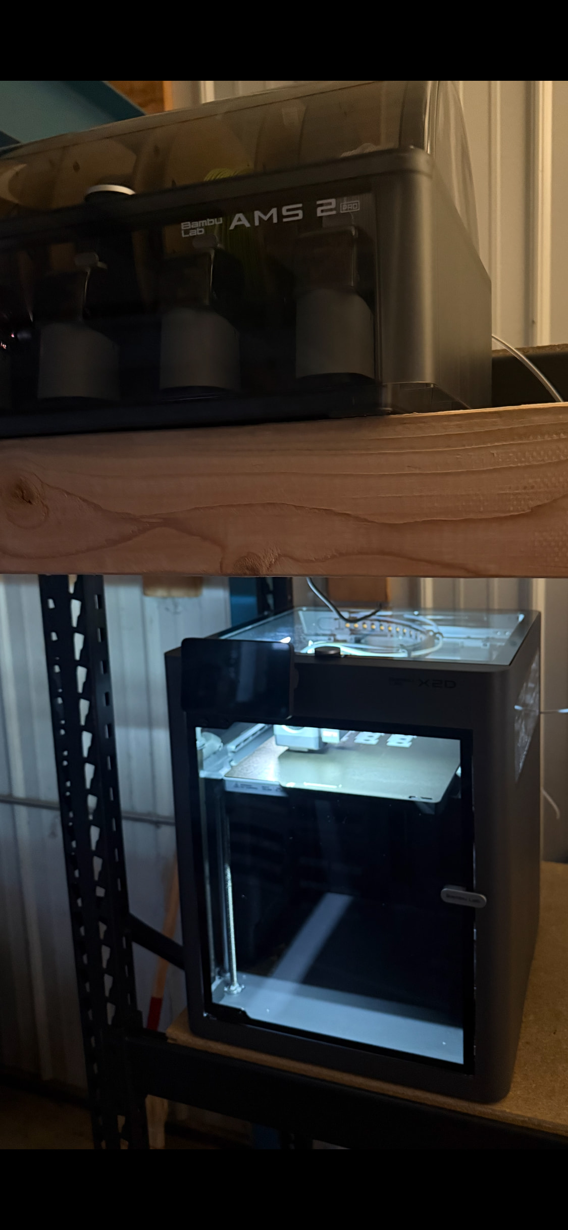

Seems by “listening and watching” the AMS is feeding much better. And I’ve already gotten the AMS in a terrible position as it’s placed in front of the printer and elevated above the machine.
