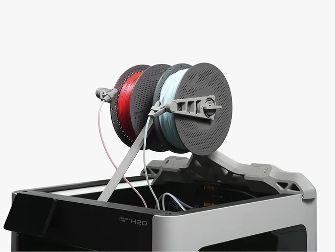

TPU 95 is fine to use through the side spool, anything below that should be fed through the port or top.
There is a dedicated TPU inlet on the printer.
Use this for TPU 95A, you can also use the main rear inlet, but you likely have an AMS 2 Pro, AMS or AMS HT connected that that.
As @3D_Prints said, any softer TPU like: 85A or 90A should be feed directly into the print head as this guide helps you understand.
https://wiki.bambulab.com/en/h2/h2d-tpu-printing-guide
There is even a top-mounted spool holder you can print to make this easy.
If you are using TPU for AMS (68D shore), you can use that in any AMS.

You would normally place the spool on a spool holder and then feed the TPU 95A through the rear TPU inlet.
  • Begin the loading process for the TPU you will find on the screen (guessing here).
  • Maintain pressure on the load as the process continues to heat the nozzle
  • Continue following the on-screen instructions
Mke sure you read all of the guide I shared above on the wiki.
Loading TPU with the dedicated inlet
  1. Remove the Bowden tube: Disconnect the Bowden tube from the extruder. This is a critical step to avoid feeding failures, as TPU is prone to jamming in a standard Bowden setup.
  2. Position the filament spool: Mount the TPU filament spool on an external holder directly above the H2S. This setup uses gravity to help feed the filament into the printer, minimising resistance.
  3. Feed into the dedicated port: Guide the filament from the spool directly into the dedicated TPU inlet port on the back of the H2S. The extruder will then pull the filament in from there,

The model above Malc posted or a 4 to 1 PTFE splitter + dual feed for the spool. That way you always have the TPU line available without needing to rearrange any tubes. The below two items is the setup Im running.
