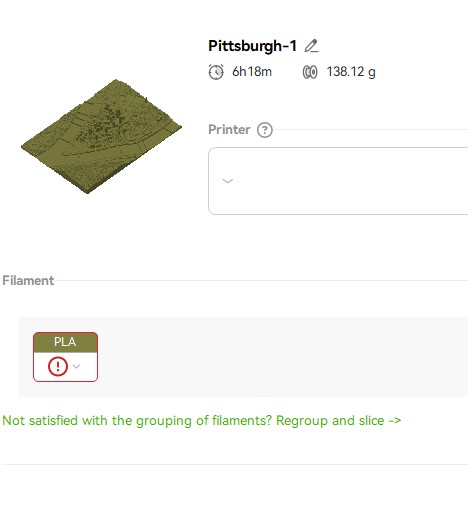

I get the following error:
Not satisfied with the grouping of filaments. Re-group and slice
Ideas on the issue and how it can be fixed? Pull out all filament from the AMS and re-feed?

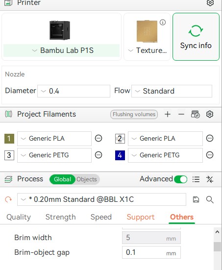

I think this is an issue with bambu studio, rather than AMS. In the Prepare tab you might have material type assignments that don’t match what you have loaded in the AMS.
AFAIK, the error means the automatic remapping that bambu studio is trying to do is failing.
How does Bambu know if he filament is PETG or PLA? TIt’s set by me, right? tried re-assigning types of each filament, but same error. This is the filament types used.
Got it. - for some reson, I have 2 printer accounts. accounts for some reason. Thanks.
Make you have the right printer selected in devices
