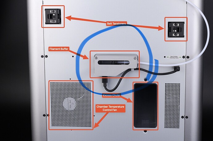

Is my filament buffer supposed to make any sounds? It make a sound that is similar to a slinky. I believe it is the spring, and do not remember it making sounds when I first bought it.

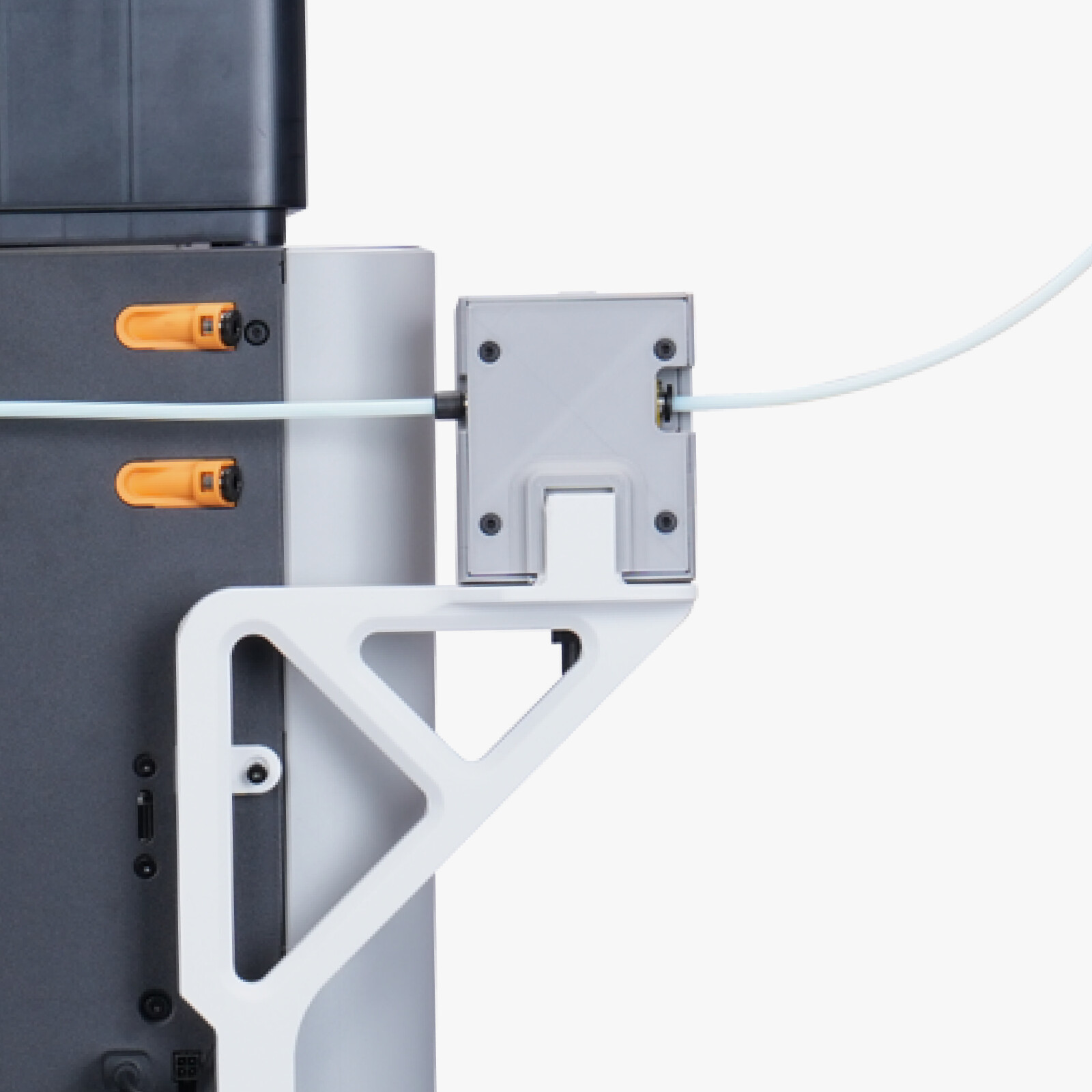

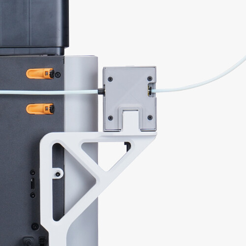

For clarity, because a new product was recently announced that some are incorrectly calling a buffer, do you mean the thing on the back of the printer that came with the X series printer or the new TPU Feed Assist Module?
This?
Or this?
https://uk.store.bambulab.com/products/tpu-feed-assist-module
Generally, no it should not.
You can unscrew it, and check for anything stuck and then put it back on.
If you have at least two AMS units, this would be a hub, not the buffer.
You can remove that and check it the same way.
Yes, it is the original filament buffer, as shown in image one. Thank you for checking on that.
