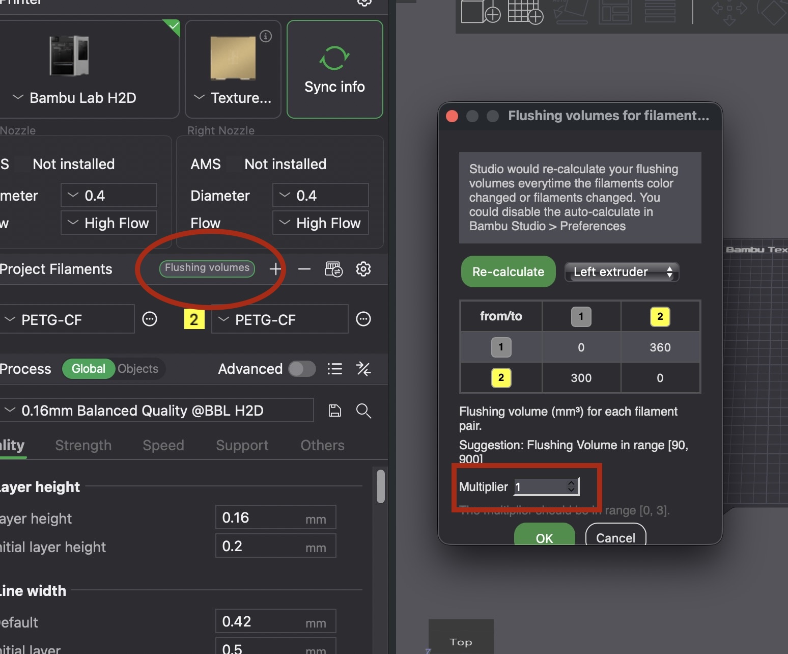

Is there a way to control the amount of filament extruded during a change? I find it too much, especially with a 0.2mm nozzle, it takes too long.
Thank you very much. Maybe I should really take a closer look at the slicer. But the filament change itself comes from the firmware, right?
No. From the slicer.
