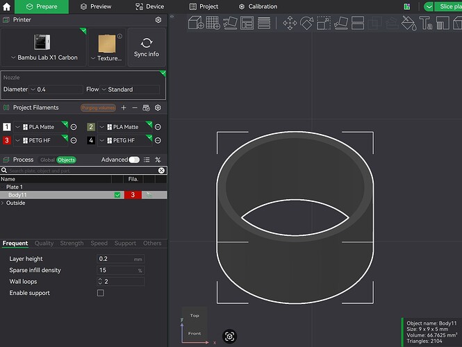

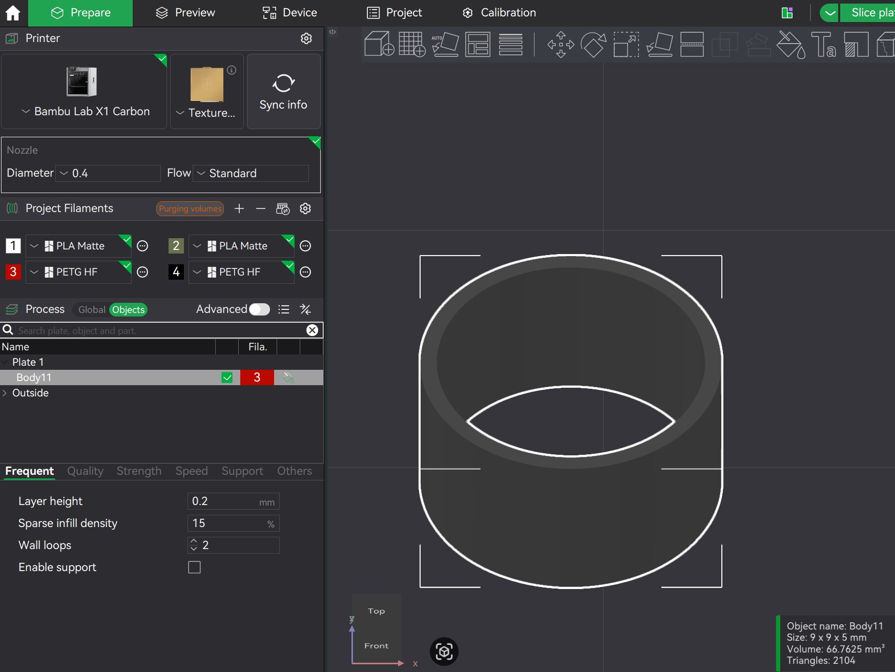

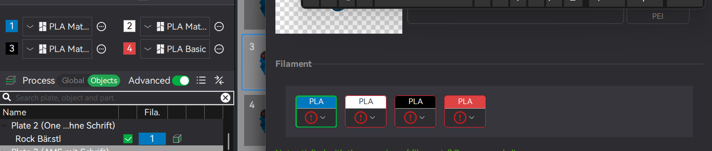

I have brought a simple test model in from Fusion and I am unable to change which filament spool it will be printed in. In the Prepare tab Objects it clearly shows the colour as being spool #3 (red PETG), but the model doesn’t reflect the change:

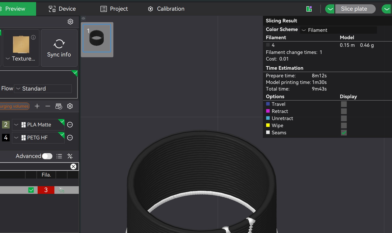

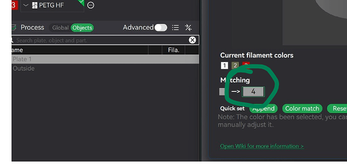

If I then go to slice the model and check the preview, it shows that it is using spool #4 (black PETG):
In fact there doesn’t seem to be any way of changing the colour or spool in Bambu Studio. This only started to happen since the v2.5 update.

Your first screenshot shows the model has been painted.
  • Select the model
  • Use the paintbrush toolbar icon
  • Select the “erase painting” button (or similar wording)
  • Exit the painting system
  • The paint icon on the right of the model entry should have gone away
  • Slice again
  • All should be good

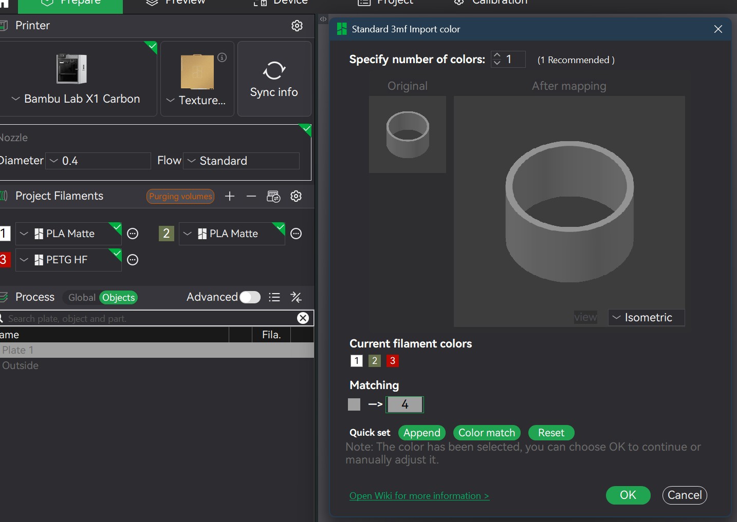

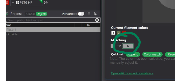

So, there seems to be a new workflow when exporting from Fusion into BS. You now get this dialogue box when BS opens:

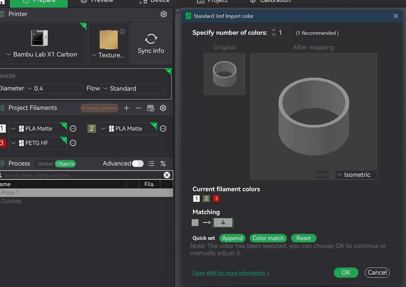

Note that the grey is not one of my installed spools. If I click OK on this dialogue, it then adds the Grey PETG to my list of spools (as seen in the previous screenshots) and it is not possible to change the colour - although it does change in the objects list (also shown in previous screenshot), but it is ignored when I slice it.
I have found that if you delete the grey PETG spool from the list of installed spools then it will immediately change to the colour that you had previously set it to, and you can now change the spool as normal.
Note that if you click on “Cancel” in the “Standard 3mf import color” dialogue then everything works as it used to. If you click “OK” then you can no longer change the colour unless you remove the newly added spool first.

  4. In BS, the new “Standard 3mf Import color” dialogue opens:
  5. Click “OK” without changing anything
  6. A new Grey filament will appear in your available spools
  7. If you look at the newly imported Objects, you’ll see that the model has been painted.

RobertWest I don’t know how you get to the screen shot above. Can you point the gray to the filament you want? picking the 4 and pointing it to the intened

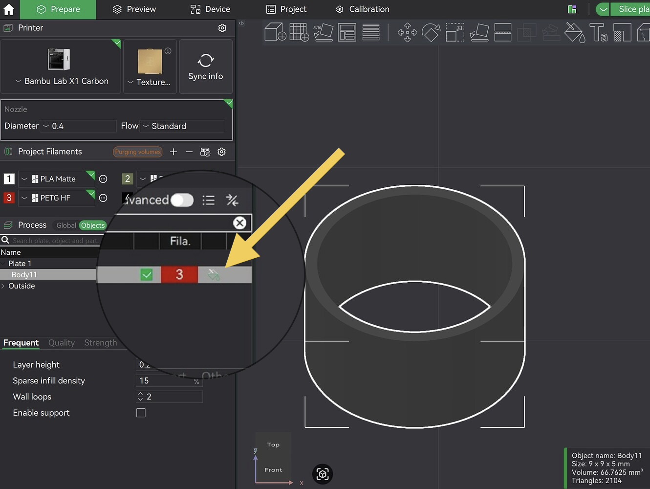

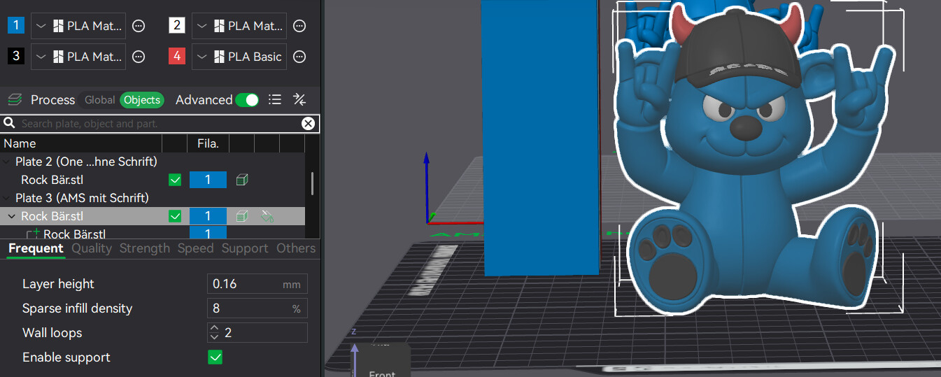

Hi Robert. It’s really easy to miss the '“painted” icon, especially in dark mode:

RobertWest notice the difference between the gray from Fusion and the Gray from AMS (filament 2). I am guessing that is where the mapping has a problem. Try using the same color maybe in Fusion, Maybe in AMS

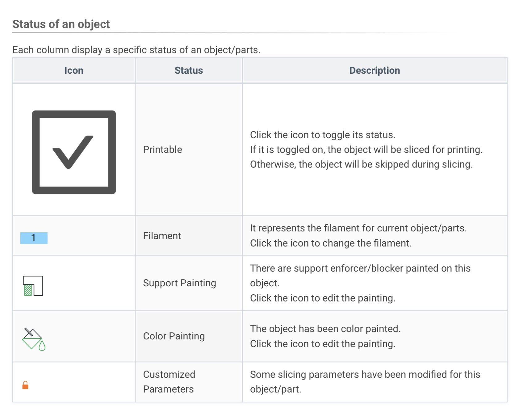

Any modifiers added to an object are shown at the end of the entry.
The paint one isn’t particularly obvious due to the outline rather than solid icon,
Thanks Malc. What other modifiers show up there?

There are many.
You already noticed the filament one.
Others
  • Support painting
  • Colour painting
  • Customised parameters
These all denote something directly affecting on that object.
You can learn more here,
