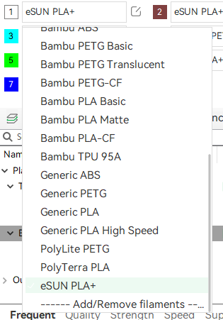

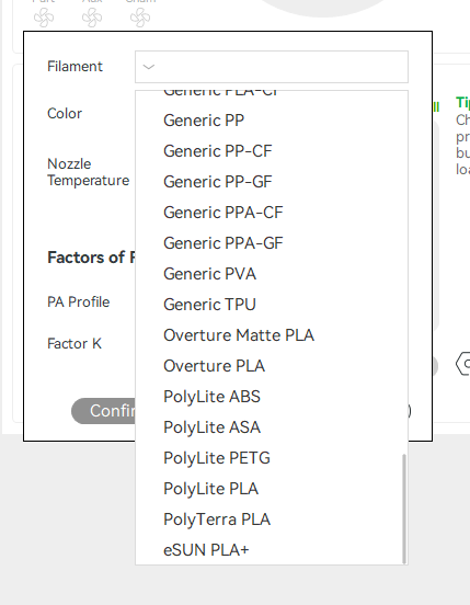

In Bambu Studio, on the Prepare tab your Filament options do not match the Filament Options on the Device tab.
For example, in the Device Tab for the AMS there are several Polymaker options
But in the Prepare tab there are only 2 Polymaker options? Is this a Bug?
Click on Add/remove Filaments in Bambu Studio and add the other polymaker filaments as required, they must be unselected.
Thanks! That was the problem
