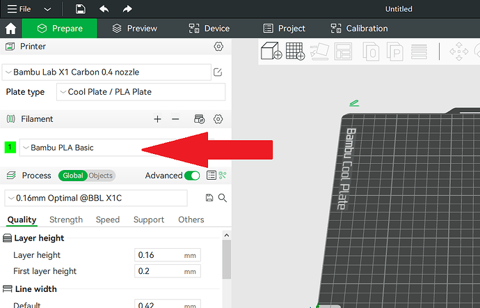

Does the filament on the “Device Tab” showing for the external spool:
Match what is showing on the “Prepare Tab” for filament?

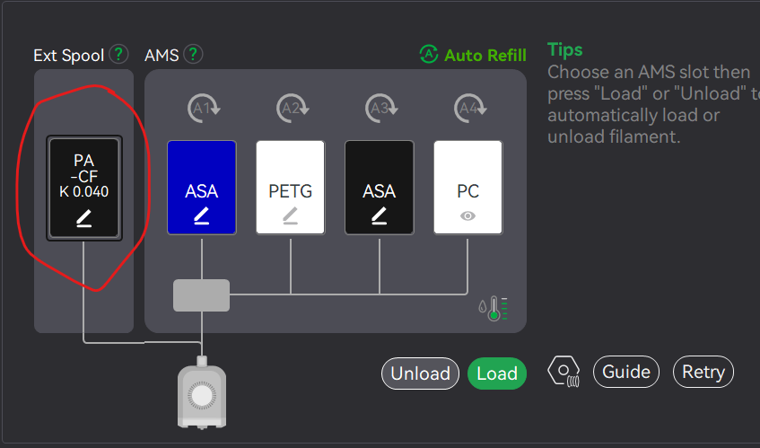

At the Device tab I do have just the EXT. Spool, No AMS.
The material is set in the Prepare tab.

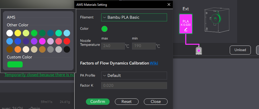

If you click the home icon (to the left of prepare) does it show you’re logged in to your Bambu account? You should have a device tab, even without an AMS. It should look like this:
The printer doesn’t know what filament you have so you have to set it manually here.
It says “AMS Materials Setting” but that is just bad coding :slight_smile:
