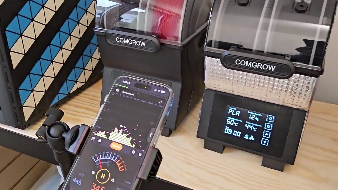

You could get the Sovol/Comgrow SH02. It has two main shortcomings - it’s noisy and it gets unreasonably hot on the bottom. The filament exit angle also sucks if you feed from it. But people made mods to address each issue, available on printables. I have two SH02 units besides the R3D D1 ones, and I’ve ordered the electronics for the quiet fan mod :slight_smile:
I’m considering this mod for the heat on the bottom: Raised feet for Sovol SH02 by Big B | Download free STL model | Printables.com
And this mod I’ve ordered parts for for the quieter fan https://www.reddit.com/r/Sovol/s/SyRVbkxe7D
There are also filament exit angle mods I might do too.
This dryer is easy to get on Amazon. (Don’t get the SH01, it’s really horrible.)

I managed to make my Sovol Comgrow SH02 to be of acceptable noise level. I think a quieter fan would have done the trick - I’m hoping manufacturers will note this when designing filament dryers.
