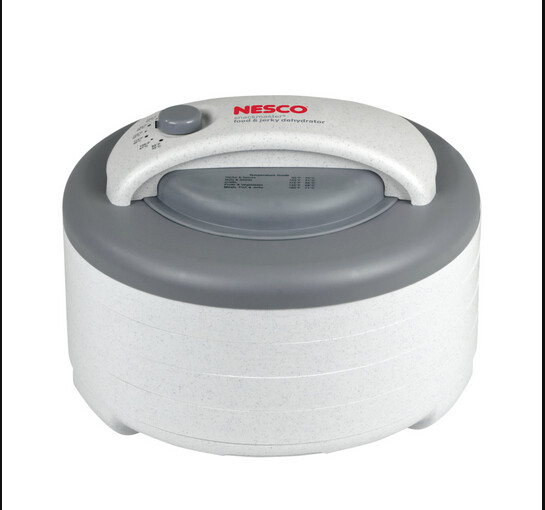

I really like the old Nesco American food dehydrators
These kind:
Search printables for your specific model, and print out risers so that each ring can hold a spool.
Compared to (at least the first gen of) filament dryers, they easily have 10x more airflow, are NOT designed to be a “sealed box” and let the humid air out, and have an adequately sized heating element to keep up with the amount of air they are shedding.
