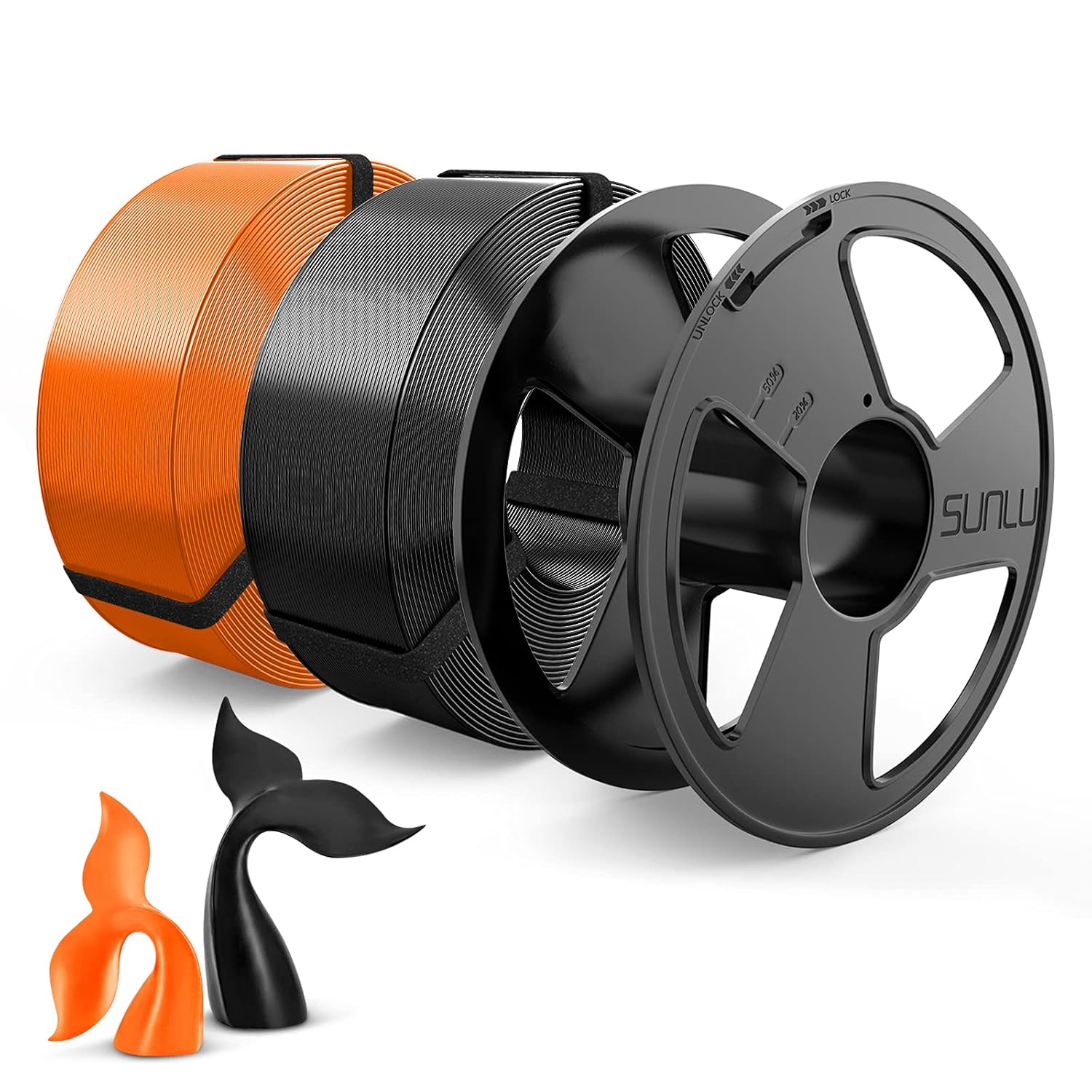

Preferably nothing at all. At least in the past, Sunlu was like that:
It came with 3 velcro straps that held the held the filament spools shape. I’d slide it onto a master spool, unhook the velcro straps, and voilà!
At least in my experience, cardboard of any kind usually arrives holding moisture, so it slows down the drying process. As already mentioned above, in the worst case it can shed onto the filament, effectively polluting it while also increasing the risk of a jam.

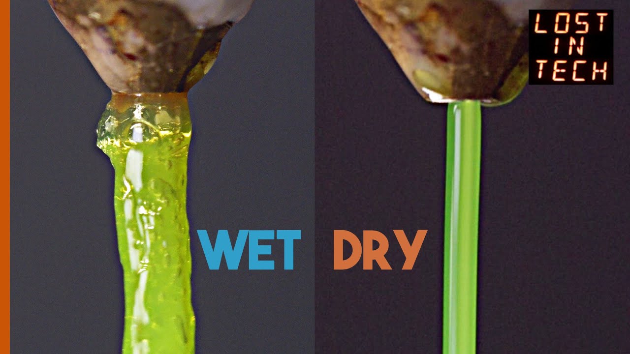

This guy finishes off his filament drying by putting it in a vacuum chamber:
For convenience, I set the time index to where he talks about it. We had talked about this approach also, but I don’t think anyone here actually tried it and reported on it. Unfortunately, he doesn’t cite any evidence, but just the belief that it helps. He puts it in for 12 hours.
Overall I think he does a far better job than most youtubes at overviewing the different aspects of filament drying, keeping it dry while storing, and keeping it dry while printing.
Possibly the best youtube overview of the drying topic yet:
Very well photographed!
Lots of detailed information in table format.
He points out that silica gel doesn’t work all that well at 50C and above.
