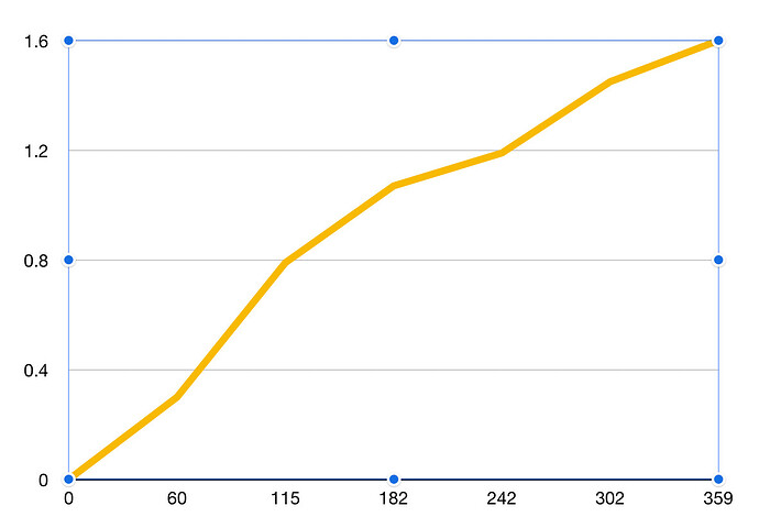

Don’t know starting water concentration in the filament but at least under these conditions definitely losing some weight. Sunlu dryer reporting 22% RH inside at 6 hours in - down significantly from 44% RH starting humidity. Ambient humidity at the 6 hour mark (and during the whole test) is 43% RH.
6 hours in total weight loss is now 1.60g with Sunlu chamber at 22% RH.
Y axis is water loss in grams. X axis is minutes of drying.
I had to cut yesterday’s test short. The spool was still losing water at a fairly steady rate give or take given the noise. The graph is weight loss in grams vs minutes of drying. The top curve is with the dry air. The bottom curve is no dry air with the door propped open using the brace. Ambient humidity is 43-43%
I was expecting more difference in 6 hours but there is just a hint of the door open curve starting to roll off. I put the dry air curve spool immediately into a plastic cereal box and sealed it up (no desiccant) so may be able to pick up where I left off if the weight doesn’t change too much from when I took it out.
The different slopes show dry air drying is faster than ambient air drying at 44% RH or so with the door propped open. But they also show pretty good weight loss with the Sunlu propped open. We’ve been having showers again and humidity is highish now. If the door open curve is rolling off that will also be important so going to get data as long as I can tonight. Once it rolls off enough, I was going to add dry air but might have to put this spool in a cereal box until tomorrow too to complete with dry air.

With dry air I dried a spool of jade white to a Sunlu S2+ chamber RH% of 22% in 6 hours for a 1.6g weight loss. This run had a slight leak at the hygrometer in a custom/replacement Sunlu base so possibly could have been better. Ambient humidity was around 39-40%. Door was closed. Aquarium pump was set at about 3/4 flow setting. This run had to be terminated due dinner with friends but weight was still dropping and this roll has been saved in a sealed poly cereal box without desiccant so should be able to continue drying tomorrow for comparison with…
The second spool in the two pack got the “stock” Sunlu S2+ with no dry air and the door propped open using blecheimer’s door prop. Ambient humidity ranged between 44% and 61% RH and it took 17 hours to lose the same 1.6g that the dry air removed in 6 hours. That was also where the open door weight loss leveled out and stopped decreasing. That’s give or take because while continuing to do measurements to make sure it bottomed out, there was variability up and down in the weights that could be noise. Measurements varied by 0.04g was all.
Once the open door spool had its weight loss level off, I hooked up the dry air to see how far and how fast it would continue to drop. So far it’s lost an additional 0.64g in 5 hours and the Sunlu RH% is showing at 19% with an ambient humidity that’s ranged between 52 and 62% RH.
So at least for these rolls and so far, dry air being pumped into the Sunlu removes the same amount of water in 6 hours that the Sunlu can by itself with the door propped open in 17 hours. The Sunlu by itself with door propped open was able to remove 1.61g of water in that 17 hours and that was as far as it could go. Adding dry air has removed another 0.64g in another 5 hours.
Neither is fast. To get to this same point on just dry air is looking like 11 hours running but the filament just keeps getting dryer still. It hasn’t bottomed out but probably will get where it’s taking way too long. Some stop at an indicated humidity of 20% in the Sunlu and it hit that between 9 and 10 hours in.
So a little more to do to verify but that is the comparison. Dry air gets filament more dry and does it faster than a propped open stock dryer. The lowest humidity the Sunlu reported with the door propped open was 32%. It never hit 20% Continuing the test a few more hours but that’s pretty much it.
