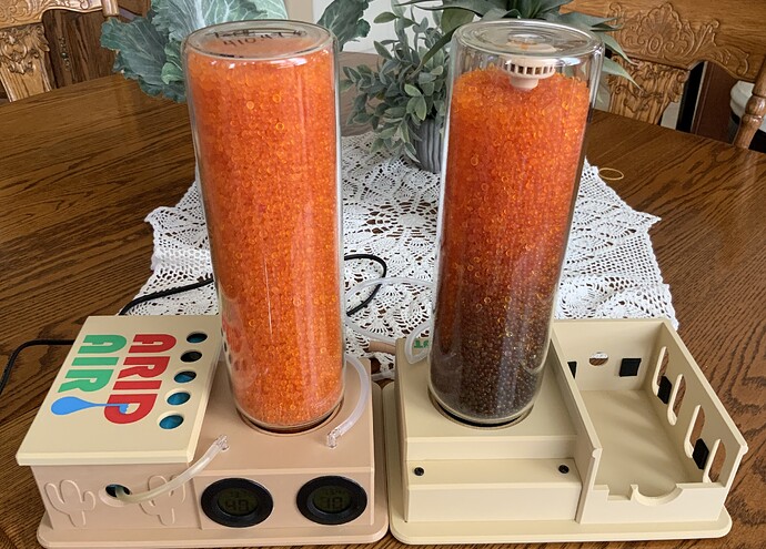

I charged the new air dryer version with fresh beads. The 3.6 pound Dry & Dry carton of silica gel beads will do two full charges of the 2 liter reservoir with about a quarter cup left over. The net weight in this new fill of beads is 804.98g. It’s actually a little overfilled.
I decided to risk “wetting up” the spool of PETG-HF so will be weighing it and setting it out to absorb moisture. It’s been in the AMS since I opened the bag with a humidity reading of 2. Will check it through the day to see how much water it picks up. Shooting for about 2g (WAG) to see if that makes the print go haywire.
I used matte latte brown for this build and matte desert tan for the old one so my pump lid (salvaged from the first version) is slightly off on color but here’s the two air dryers - one with the desiccant after 25 full spools were run through the dryer, and the new one now with fresh desiccant. The color change really stands out.
