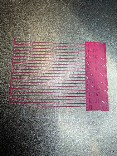

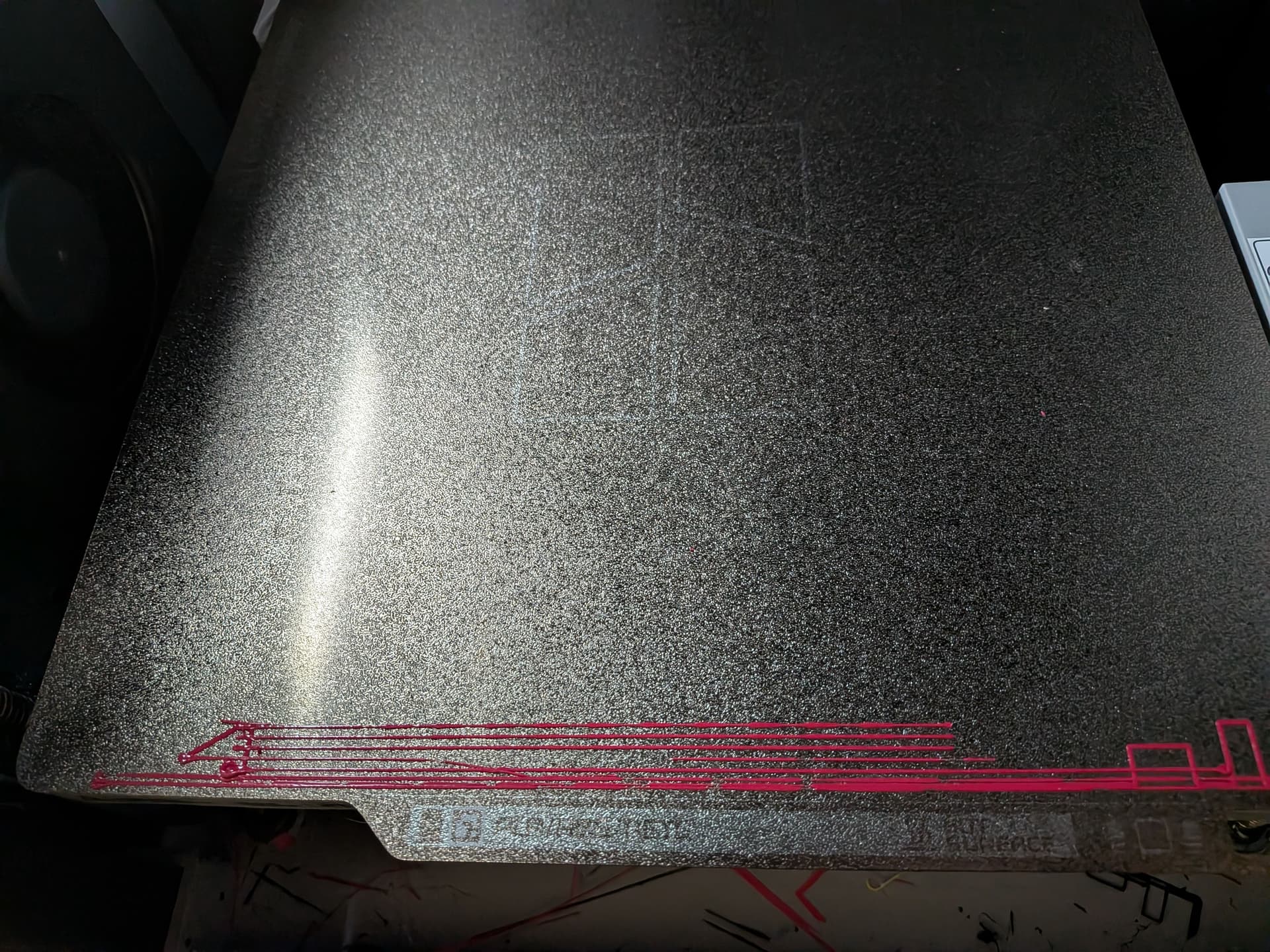

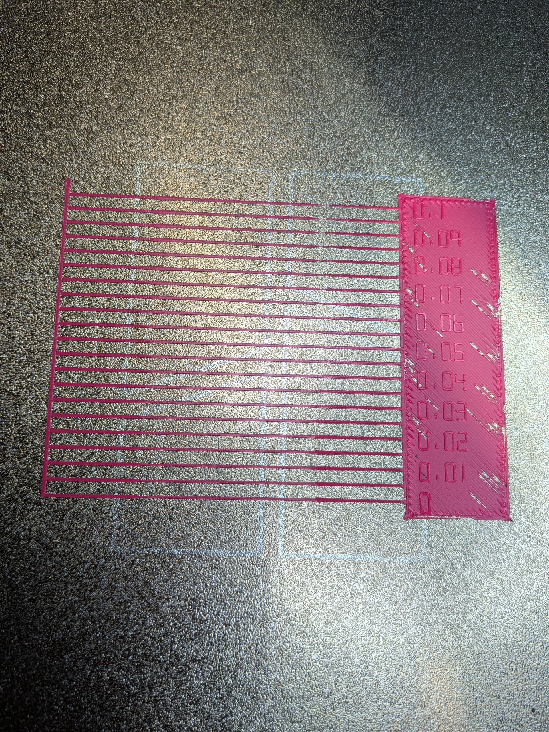

For example, recently I tried to recalibrate the printer using the menu on the printer and checked all options then I went through the flow calibration where you need to manually find the best “K factor”. Below is a picture of a recalibration attempt using eSUN PLA+ Pink filament.
I of course did dry the filament, I tried multiple different eSUN PLA+ filaments because those were working just fine before. Changed the desiccant, recently dried in the oven. Changed the AMS slot. Tried to unclog the nozzle. Recalibrated the printer many times. Tried multiple models (I didn’t set any specific settings in Bambu Studio, I usually just use the defaults and only change the project filament and process to use the eSUN provided printer profile).

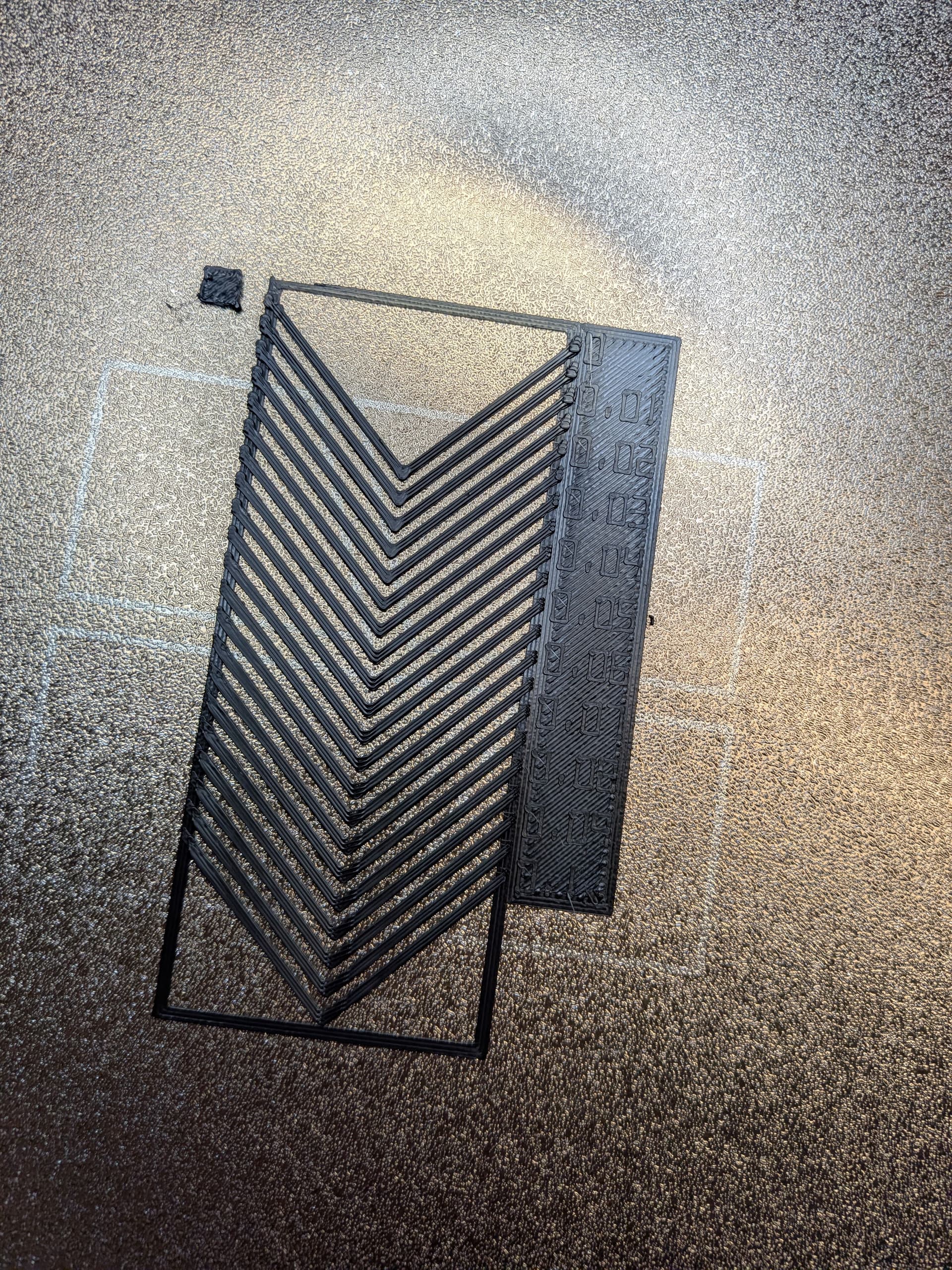

I of course tried using original Bambulab PLA filament. Did run the calibration with it too. The test does look better with the original filament. See picture below.

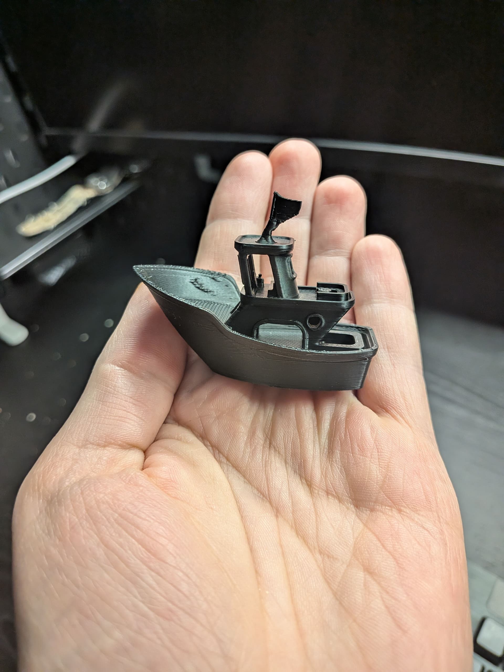

But I can’t say it is doing a great job with a random model either. See picture below of a Jachty.

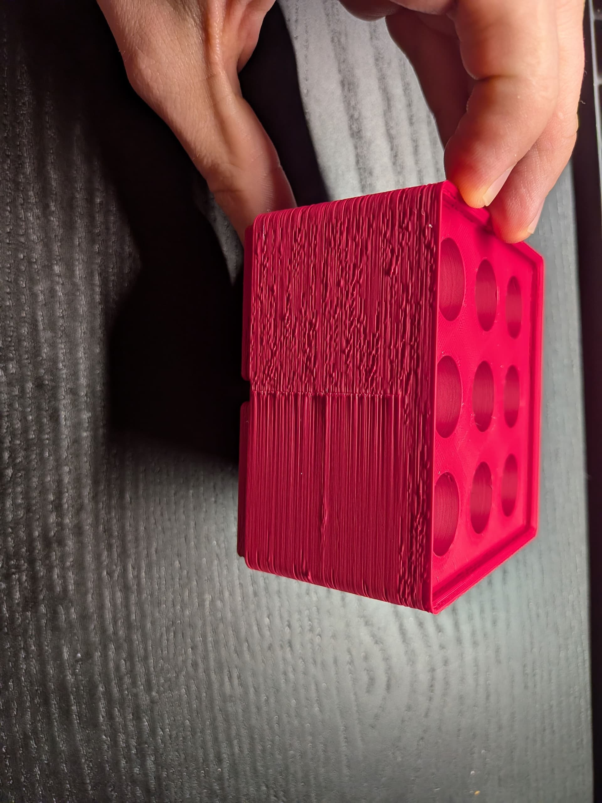

For my last attempt I tried printing out this model: Gridfinity Custom Makeup Bins #HappyWifeHappyLife - Free 3D Print Model - MakerWorld
Selected X1 Carbon, Download 3MF. I think I selected the 22mm print plate, changed the filament to eSUN PLA+ along with the process and then I just printed it. The result is not great. See picture of the box below.
The box is quite fragile, you can easily press it with your fingers and the individual strands of filament breaks. This happens to all sorts of models. Note that I have printed out similar models many times with many eSUN PLA+ filaments and they turned out just fine. You can also see that something is wrong when the printer is doing the flow calibration before it starts printing.
