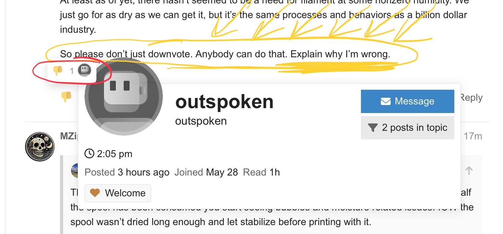

Dude, don’t just downvote. If you disagree with me, explain where what I say is wrong. Don’t just interject “it doesn’t work” or other pat comments.
If it doesn’t work, what is the physical basis for it not to work?
I’d really like to know if I am indeed wrong. I haven’t just taken a position for the hades of it. I have a background in this stuff and have done lots of additional reading of desiccant industry papers and articles.
First you should know humidity in a closed container is exactly how the desiccant industry tests their desiccants. It’s also how they prepare their desiccants. You can buy silica gel pre-packaged in 5% RH increments out of on the shelf stock. They sell it to the museum and archival storage industries so it can be used to help preserve different items. If they want to preserve some document at 20% RH because they last the best at that humidity, they buy 20% RH beads and put them in the display case. But you can also buy beads in 1%RH increments special order.
They make those measurements all the time using relative humidity. So if it works so well with desiccant testing and prep, why is it invalid when applied to filament? The fact is filament also has desiccant properties and can be treated like a desiccant itself. Everything they do in the desiccant industry can be applied to filament. The biggest difference is we just want dry filament. At least as of yet, there hasn’t seemed to be a need for filament at some nonzero humidity. We just go for as dry as we can get it, but it’s the same processes and behaviors as a billion dollar industry.
So please don’t just downvote. Anybody can do that. Explain why I’m wrong.

You aren’t so outspoken now, are you?
You keep just downvoting. I swear I am able to hear other sides but you need to back up why you think I’m wrong. It’s not helping your case to ignore the facts and just hit my posts with downvotes.
If you can justify your position, please do. But at this point I don’t think you can. So until you are willing to actually discuss this stuff intelligently, downvote away my friend. But it just makes you look silly and unable to justify your opinion.
