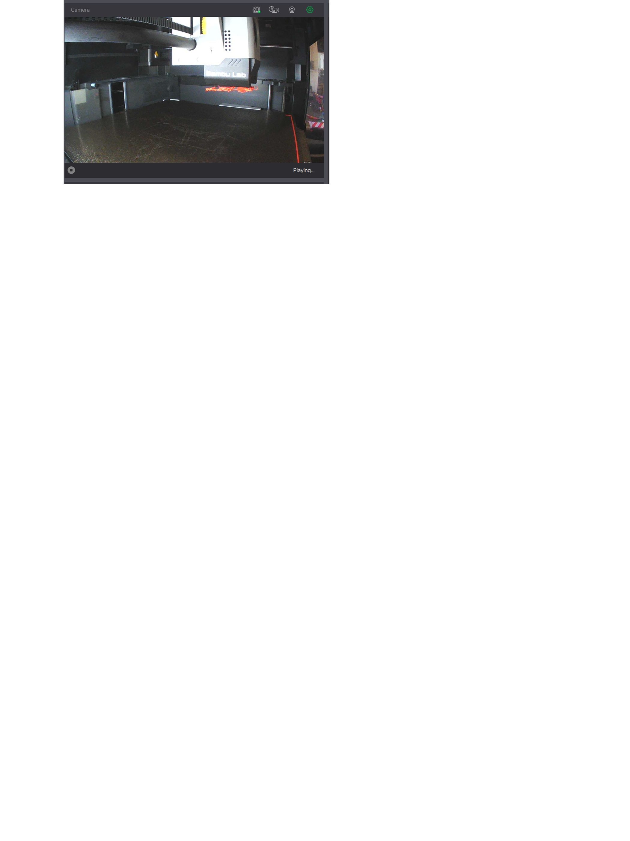

This has just randomly started happening,
*UPDATE seems to have coincided with the new update to bambu studio !
bambu p1s with AMS ( no matter what AMS slot, this still happens
Bambu filament and accessories unless otherwise stated
both with PLA Matte and PETG HF
I will do my best to describe
all the print profiles and settings i have used previously and with success i am using now, all of the profiles are from makerworld
for some reason my prints the 1st few or initial layer is not sticking to the build plate. either the Smooth or textured PEI
i have washed both with dishwashing detergent and hot water only
like i have been doing for months, i have dried with a towel, air dried and used the heat bed to dry the water, no dice
I have been using a 0.4 hardened nozzle,along with the hardened gears have cleaned the nozzle and replaced the silicone sock, nope
i have just tried a 0.4 standard nozzle and still same issues
I did some searching and tried different 1st layer speeds ( with the PETG HF )
even a hotter bed and nozzle , nothign has worked
its as if the starting Z height is wrong or the bed is on the piss somehow
i have give all the ball/lead screws a good looking over in case debris is caught, but i cant find anything
this is a pic of what happens
any help would be appreciated

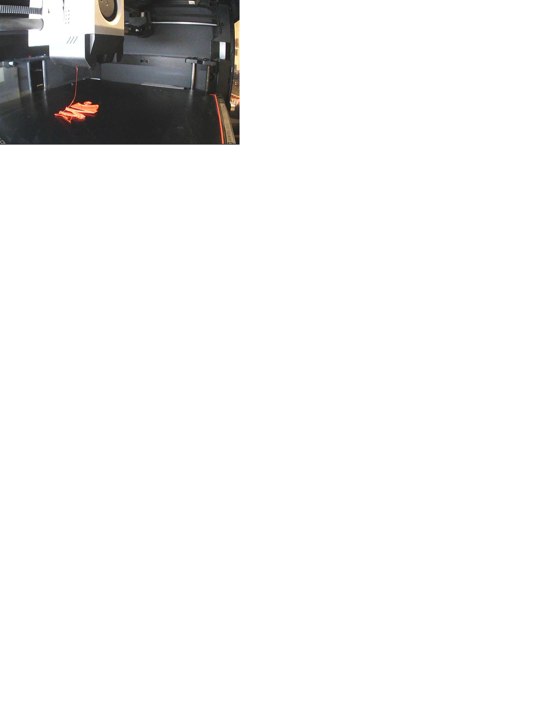

here is this mornings failure , what i dont get is that the line that is done 1st at the front of the build plate sticks, nothing else does
Did you also do it after the firmware update?
I would also recommend washing the plate with warm water and detergent, as it seems like there is some debris on it which might impact the adhesion.
Probably the best way to verify this suspicion is to revert to an older version of the BS (downgrade). If everything starts working again, then the problem is indeed somewhere in the BS. Otherwise, something else has changed somewhere …
Personally, I am interested in the result because I keep postponing the installation of the new BS version… out of habit… I always wait to see if everything will be OK… pretty often is not and some waiting makes sense :slight_smile:
I actually did revert back last night with no change. even after a calibration.
as well as drying pla matte.
I have installed the new Version this morning . will do a calibration and test print again.
