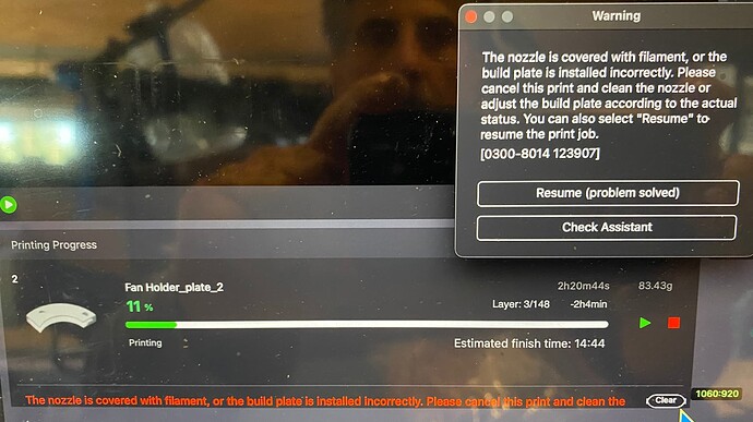

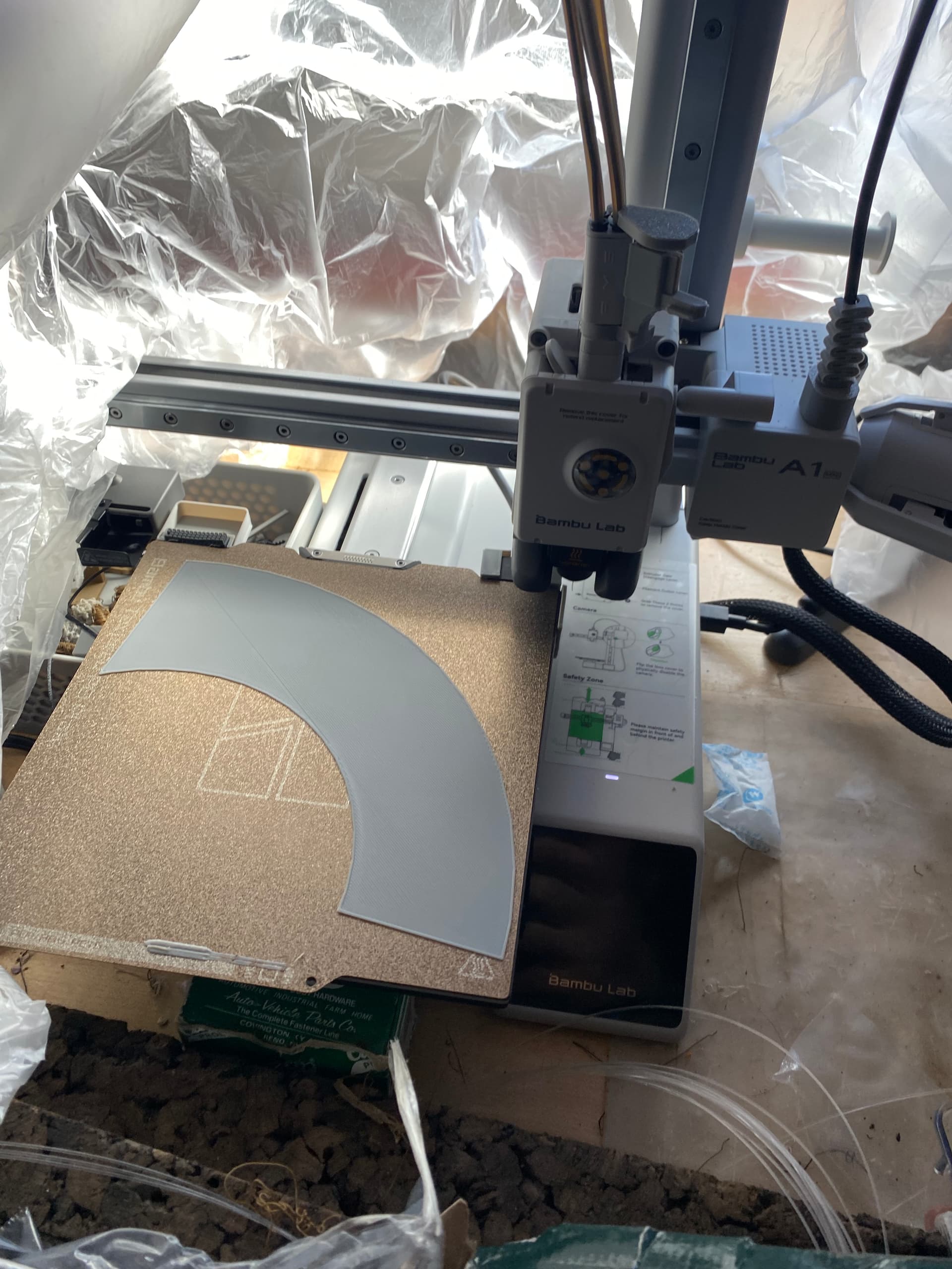

Filament, or improper plate reocurring failure. A1mini
It happens each time at roughly the 4th layer.
On PLA, PLA tough, and Petg HF
Misc Print files.
My first prints before the last firwmare worked. Didn’t do many, I’m new to printing.
Since the update this keeps happening.
I wipe off the stream from the head and hit continue and it finishes.
Bambu itself has not responded to my inquirey
Thoughts please.

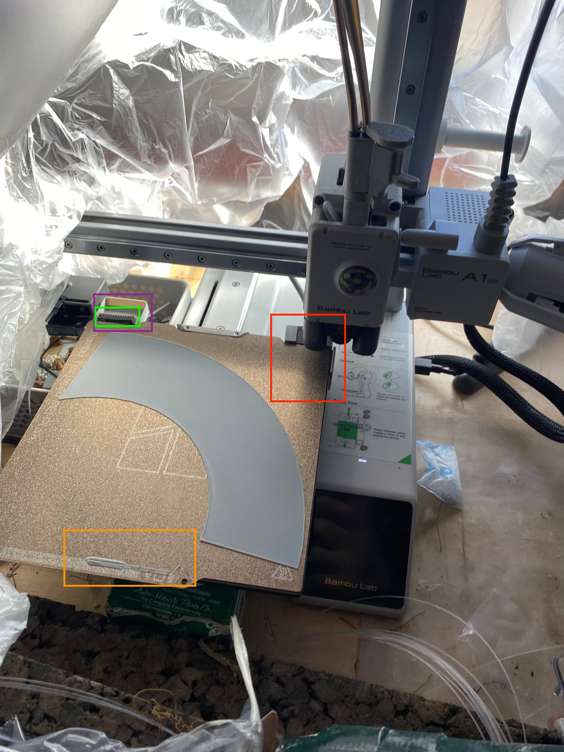

I recommend you remove things that can cause problems and see what happens.
  1. Yellow: You have two prime lines; always remove the previous one before starting a new print.
  2. Red: Remove this addition.
  3. Purple: Remove this addition.
  4. Green: Stick the nozzle wiper down properly.
Will do thanks. the primelines, maybe.
The other 2 issues unlikely. As said by the novice.
