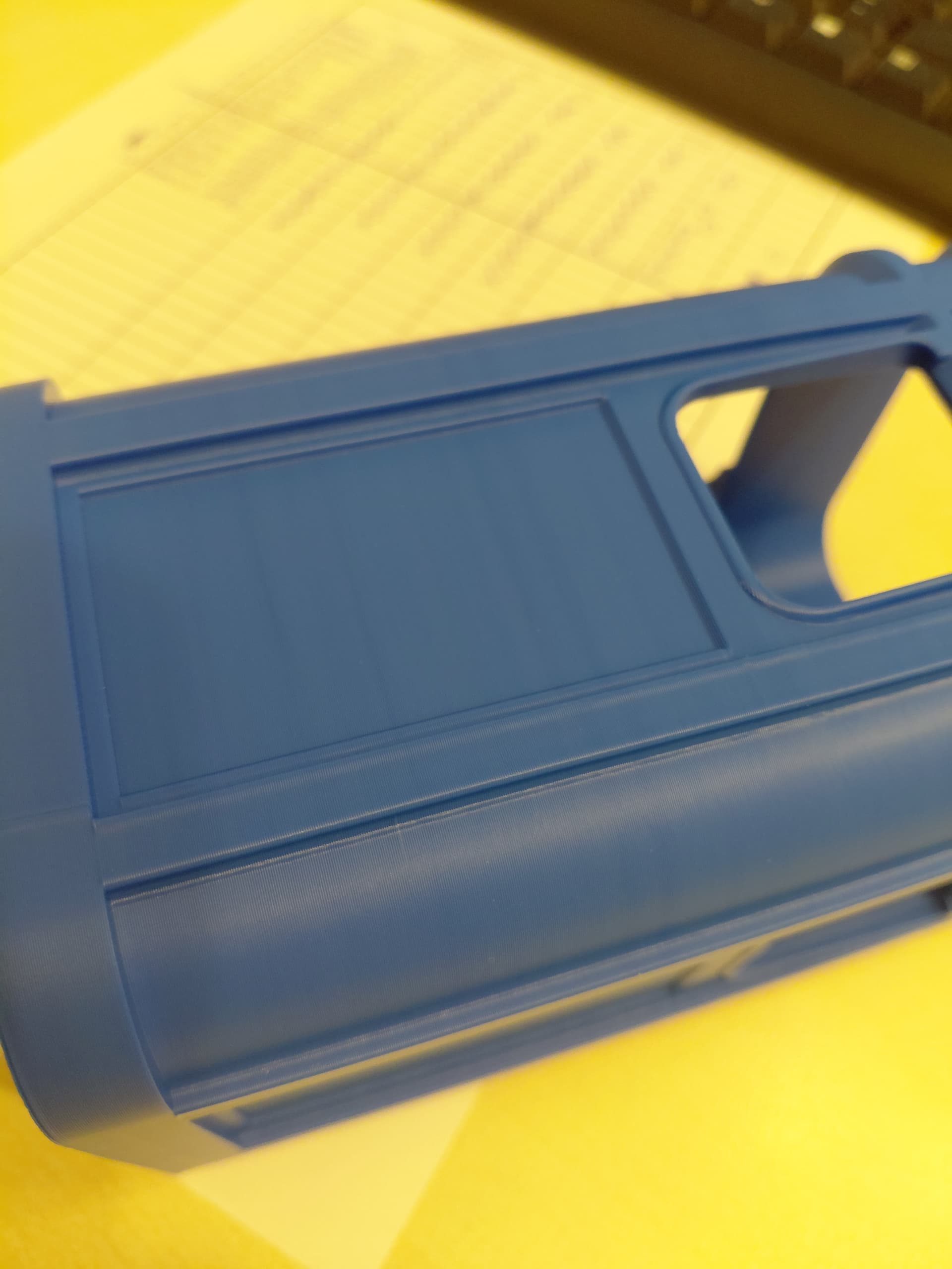

I’m also having various problems, but only with cobalt blue. Suddenly I’m getting streaks even though the filament comes from the same spool. This doesn’t happen with other colors. Has anyone else experienced this?
