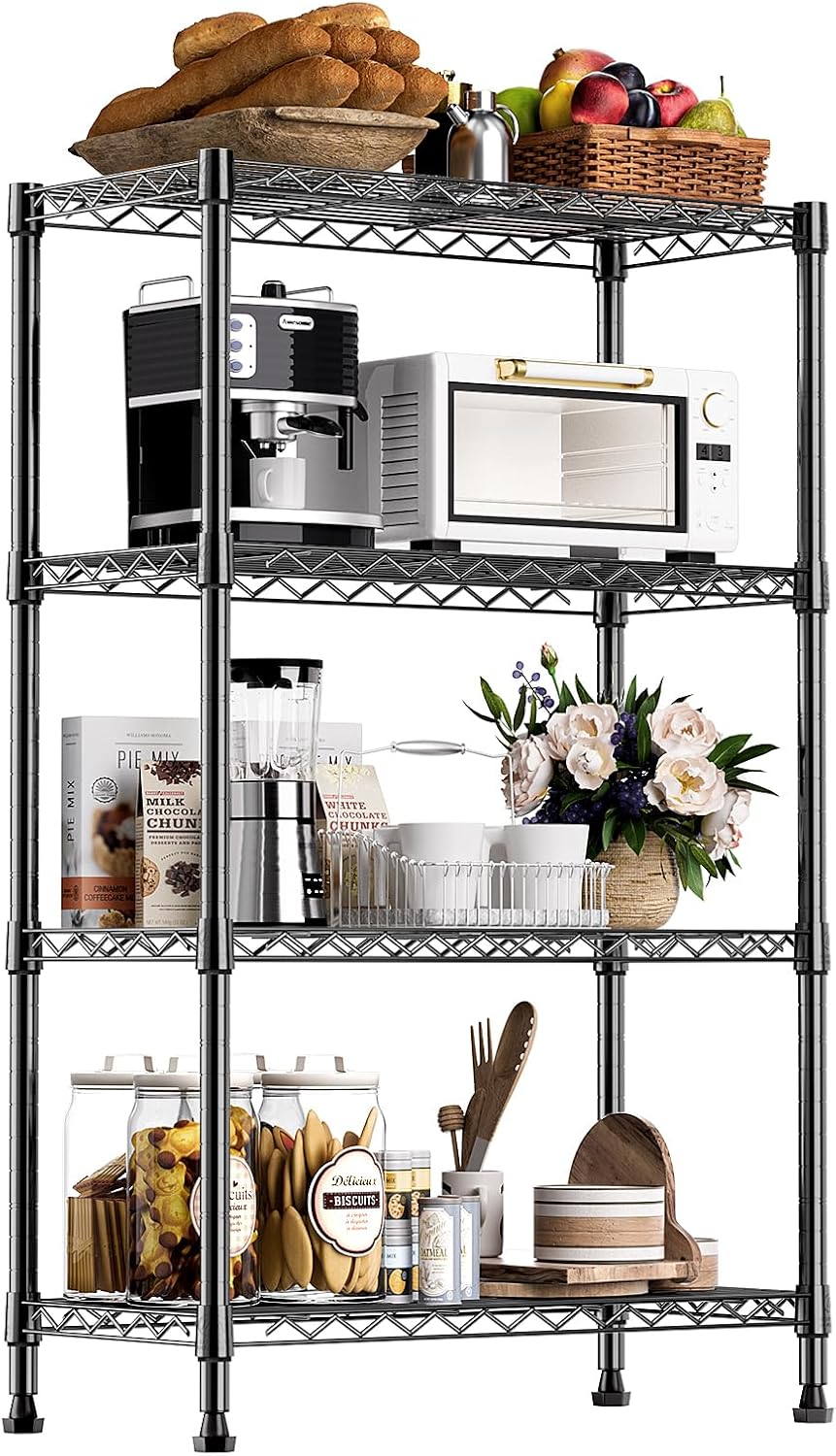

I use wire shelving for my in use filaments. A cupboard for my spares and against a wall on a desk for my non-Bambu Lab ones.
This is one example of the wire shelving, the come in many sizes, I have several for many uses around the house.
M MZG 1000 lbs Storage Shelving Steel Heavy Duty 4-Tier Utility Shelving Unit Steel Organizer Wire Rack for Home,Kitchen,Office,Black 35 x 60 x 135.8 cm
