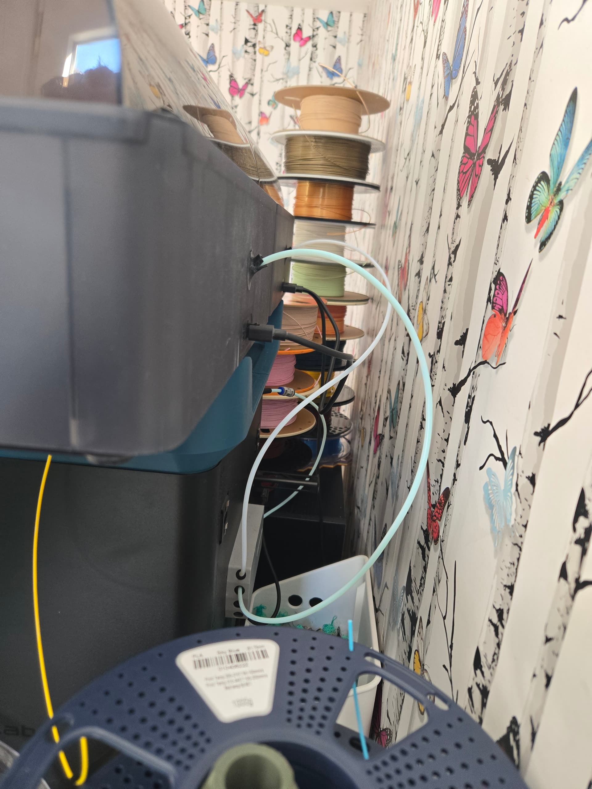

Did you replace ALL the PTFE tubing? Do you have large radius loops of the tubing. That gets to be important if you have multiple AMS devices. with tight curves the filament is going to rub the tubing with more pressure than if the loops are big.

I will provide some pictures of the tubing.

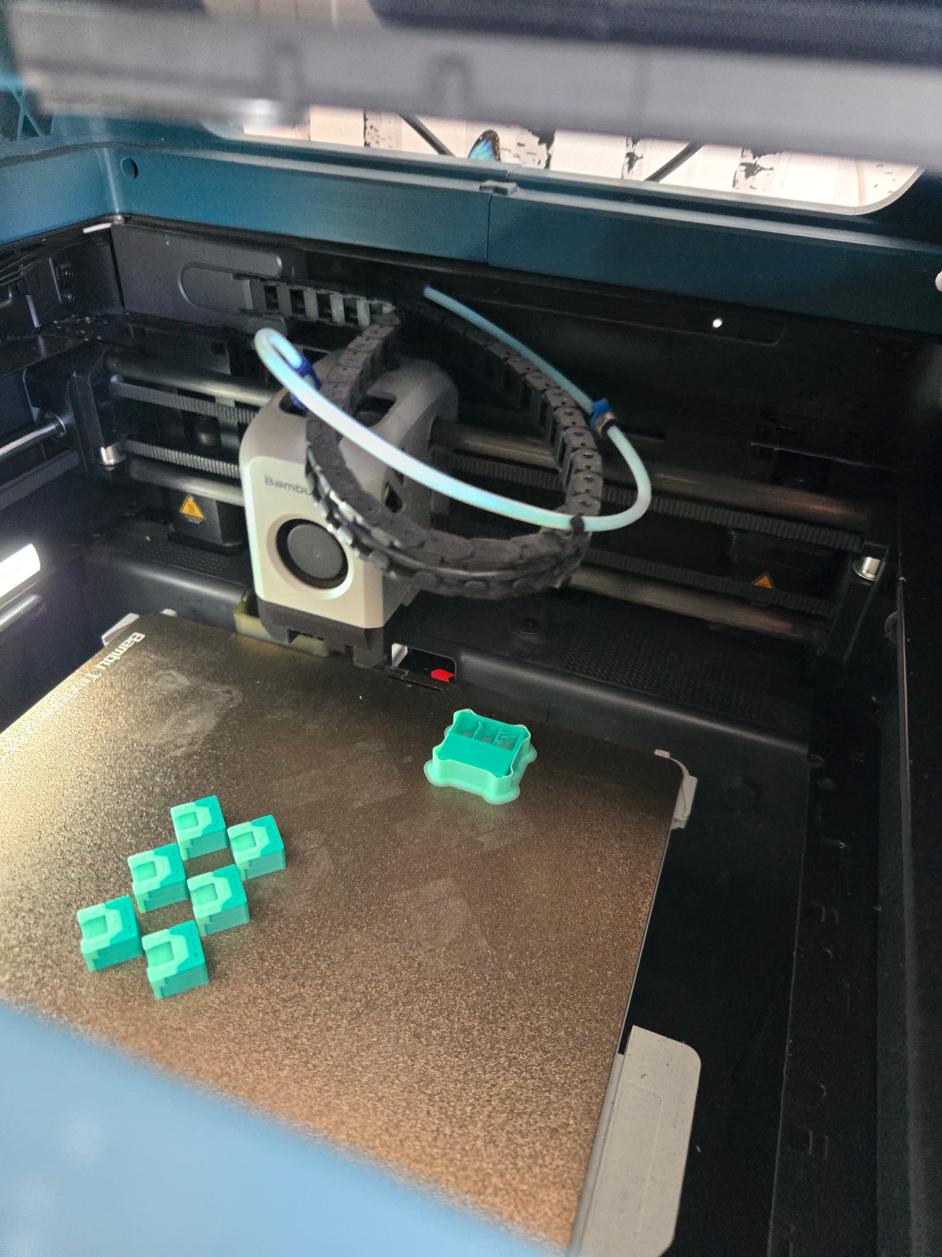

The filaments I use in the picture are Sunlu Mint green and Elegoo Green (can’t remember the exact name of the green right now).

The issue is in every pic you post.

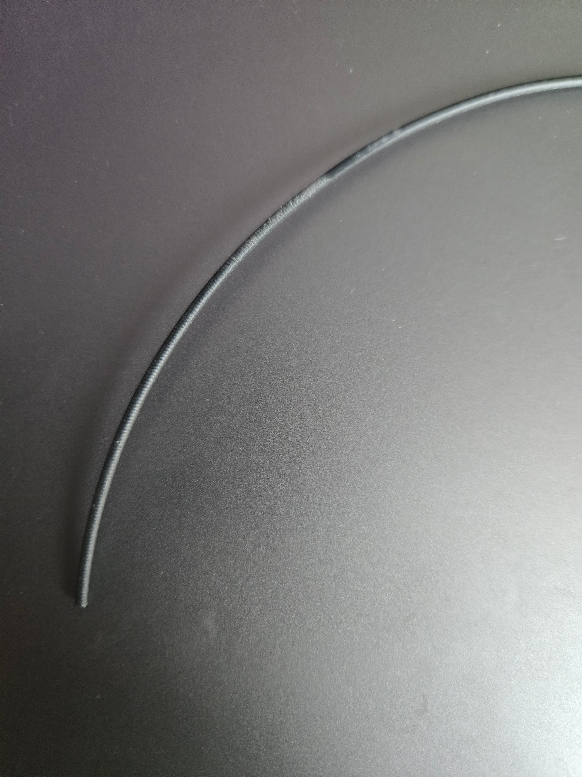

I’ve finally managed to pinpoint where the problem with the filament occurs, but not what actually causes it. Right at the point where the AMS grabs the filament, the filament gets damaged. See the picture. I can see the usual bite marks from the feeder when it pulls the filament down, but at the very tip, after it has gone all the way through, the filament gets damaged.
This damage is severe enough that the filament jams and the AMS can’t feed it any further. The softer the filament is, the more frequently the problem happens. With PolyTerra it occurs more often compared to, for example, Sunlu. When it happens, I hear a sort of “hard retraction sound,” but it doesn’t occur every time.
Why is the filament getting chewed up like this?
When you load a roll and stick the filament in the funnel you say it hangs at that location and won’t go any further?
It could be getting hung up in the PTFE that is below the bottom. If you have never had to disassemble your AMS, there is a lot going on under the bottom of the AMS. Lots of opportunity for trouble.
