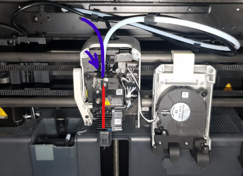

If I understood right in the picture bellow the filament stuck bellow is in color red and by pushing new filament in the blue (first heat the nozzle and in the set to extrude filament) your stuck filament should be melted and it should be solved.

That’s the issue. your picture looks about right. I heated it to 230 degrees and pushed and pulled the filament with no movement, I even tried doing it while manually extruding either in or out and nothing moved. just stuck. I have a length of filament coming out of the head, but I’m afraid if I cut it shorter it will just make things worse. I have had to before heat up the nozzle and puch the filament out but the extruder was working then.
If you cut it, and it still won’t move up or down, youve likely got a “heat creep” bulged piece below the extruder gears and before the nozzle. You can do some risky things with heat to try to soften it more, so that it can be pushed through or pulled up, or you can disassemble the extruder unit and fish it out that way. Imagine those cartoons with a snake that ate a basketball. That’s the sort of thing you might find in there preventing the movement.
