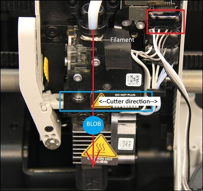

As part of the End of Print process, the printer sends the toolhead to the front left corner of the printer where it pushes in the filament cutter across the filament path and cuts the filament just above the hotend. The AMS then reels it back onto the spool.
I have an AMS so this is a guess on my part but if you don’t have an AMS I assume one has to manually pull the filament from the extruder back to the spool and the last step is to cut the filament, whereas with me the last step is for the AMS to rewind the filament back to the spool.
If you are getting a blob too big to run back up the PTFE tubing it may mean that the filament cutter is bad because the cutter is above where that blob is.

That’s right, I forgot to mention that I’m running two AMS on the P1S. The P1S is now over a year old. I replaced the filament knife two months ago. The filament is cut correctly above the hot end. The lump forms above the knife. I suspect that the filament is still soft and is being deformed by the gears, and then no longer fits into the PTFE tube. If I have enough slack to pull the PTFE tube out of the extruder, I can usually pull the filament out of the extruder with a little force. Sometimes, however, the filament breaks and I have to open the extruder.

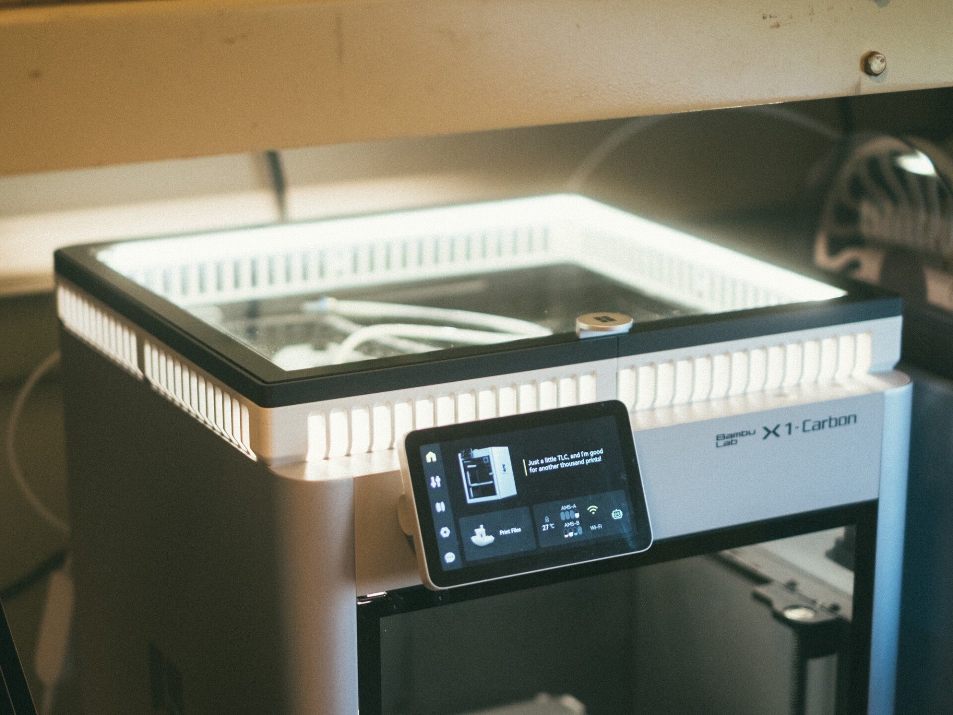

I will leave the door open for now. It is not too hot here at the moment. Approx. 28°C in the room. The P1S is free-standing in the living room. I have a LED riser, which I will replace with a LED riser with ventilation slots so that the heat can escape more easily.
ended up having to replace the nozzle as it was severely clogged(couldnt unclog it). seemed to print fine with door and top open. Going to be printing the riser set to have more ventilation.
The riser is a great solution, solved my heat creep problems AND still can plonk the AMS on top. Put some electric tape on the surface the glass will rest on, and it will stay rock solid
