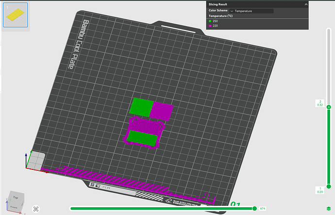

The weird part is, it also shows up properly in the Bambu Studio G-Code preview…
(Supposedly setting the nozzle temp to the printing temp of 250C)
The preview line types even show it should be printing at 250C.
But when I sit beside the printer for this entire test/troubleshooting print, the printer just seems to ignore this G-Code and go on its merry way of printing the filament at the max/purging nozzle temp set in the slicer instead of the proper printing temp.
