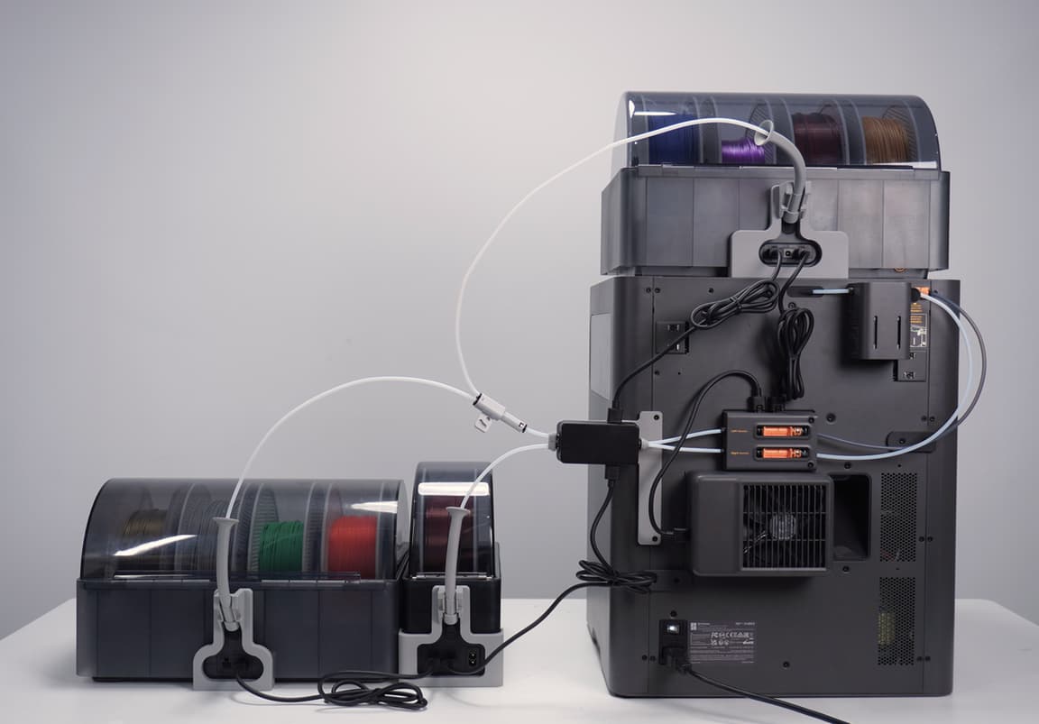

I’ve just ordered the X2D and I’m already really excited to get started. That said, one small detail is already “bothering” me a bit :grinning_face_with_smiling_eyes:: the filament Track Switch sticking out the back.
I was looking at the rear of the printer and wondering whether it might be possible to relocate the filament track switch to a different position.
Below is an image showing a potential alternative mounting spot that could keep things a bit more compact and tidy, assuming we design and print a couple of dedicated brackets for the track and the buffer.
Of course, I realise this might also require moving the buffer, so it’s probably not a straightforward change. Still, I’m curious:

I don’t see any concern, in fact the H2D location is planned to be in the middle of the back. Just design some brackets to move the switch and the buffer
Right, that’s good to know, thanks!
I’ll probably end up designing a couple of brackets for both the switch and the buffer and see how it works in practice.
Curious to see if there are any hidden downsides once everything is moved around… but I guess it should be fine!
It will just be more difficult if you attach more AMS and need to disconnect at the switch if it’s burried behind the printer and you may need slightly longer PTFE tubes depending on the AMS(s) location but other than that it will be fine

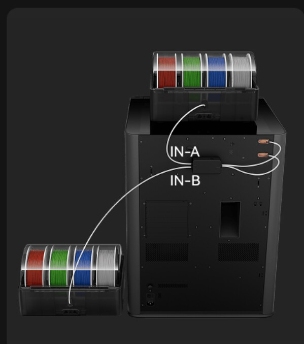

How would you connect more than two AMS then? I’ve seen setups with 20+ filaments, so I’m trying to understand how that works without adding restrictions.

Well, in my case, I have one AMS and one HT. The AMS would normally be connected to the main nozzle, but if I want to print something with a main colour, a secondary colour, and PLA support, things get a bit tricky.
Without the switch, I’d have to manually swap the tubes depending on what I want to use. With the filament tracking switch, I can keep everything connected and just route the filaments as needed, which makes it much more convenient.

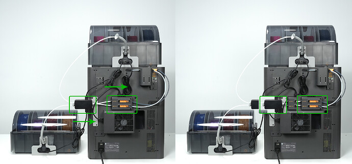

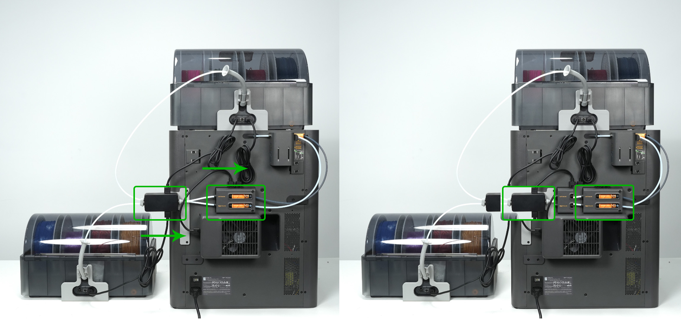

I’ve been thinking about this too. Just seems odd to have it stick out so much from the rear, and also have those twists in the PTFE tubes. The filament feed into this printer is bad enough as it is, this will only make it worse.
I’d like to rotate it 90 degrees, and them mount it closer with almost no PTFE length into the buffer. However, the holes don’t align well enough, and the communication cable will get in the way, so I’d also have to move the plug for that cable. This will likely end up in a full reconstruction of the box for this feeder switch. My CAD skills suck, so may be a long time before I get to this project.
I just do not understand why they didn’t just make this unit kiss right up against the feed buffer. OR replace it completely! So many better ways to have done this. They must have been in a hurry or something.

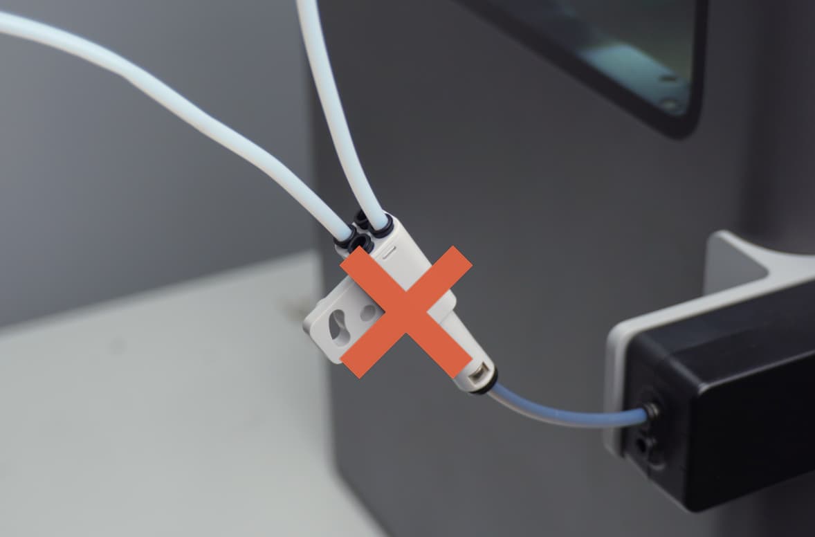

Q: Can the 4-in-1 PTFE adapter be used when only two AMS units are connected?
Using the 4-in-1 PTFE adapter with just two AMS units is strongly discouraged; the extra resistance during loading and unloading can compromise print reliability.
from
So magically if you have 3 AMS units or in my case 1 AMS Pro and 3 AMS HT it does not have a problem? Their statement does not compute.
The magic lubricating smoke must escape out the 2 open holes maybe. I don’t know, didn’t write the wiki. The associated picture does show a specific setup. Maybe it causes excess movement of the entire assembly.

I understand that if you have ONLY 2 ams you shouldn’t use the 4-in-1, of course!
But still, “resistance during loading and unloading can compromise print reliability“..?
So, how do we connect properly 4 ams?!?!
That’s a complex question. There are many options for connectivity. Using the 4 in 1 adapter with the Track Switch is noted in Bambu Labs documentation as not a good option. Though that doesn’t really stop anyone from trying.
Basically, do anything you’d like to try. Your results may vary wildly. I just wouldn’t expect Bambu to help out much if you try something outside of what they document as norm. I and others here will likely help out though.
If I read into Bambu’s statements, seems that if you do connect 4 AMS 2 Pros, you shouldn’t use the Track Switch. Not sure if anyone else would agree. I’m not even sure of it’s usefulness overall just yet, even with a simple setup like Bambu describes. Just to optimize filament usage for less waste? But to me seems that it also adds complexity resulting in printer babysitting. Give and take it seems.
