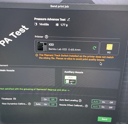

Filament track switch warning, but I don't have one installed
I haven’t installed a filament track switch, nor does one show up on my device info page in Bambu Studio. So where is this warning coming from and how do I get rid of it?

It’s any file. Restarted studio. Used Bambu, generic, and custom filament profiles. AMS-HT’s are setup per the ams menu.

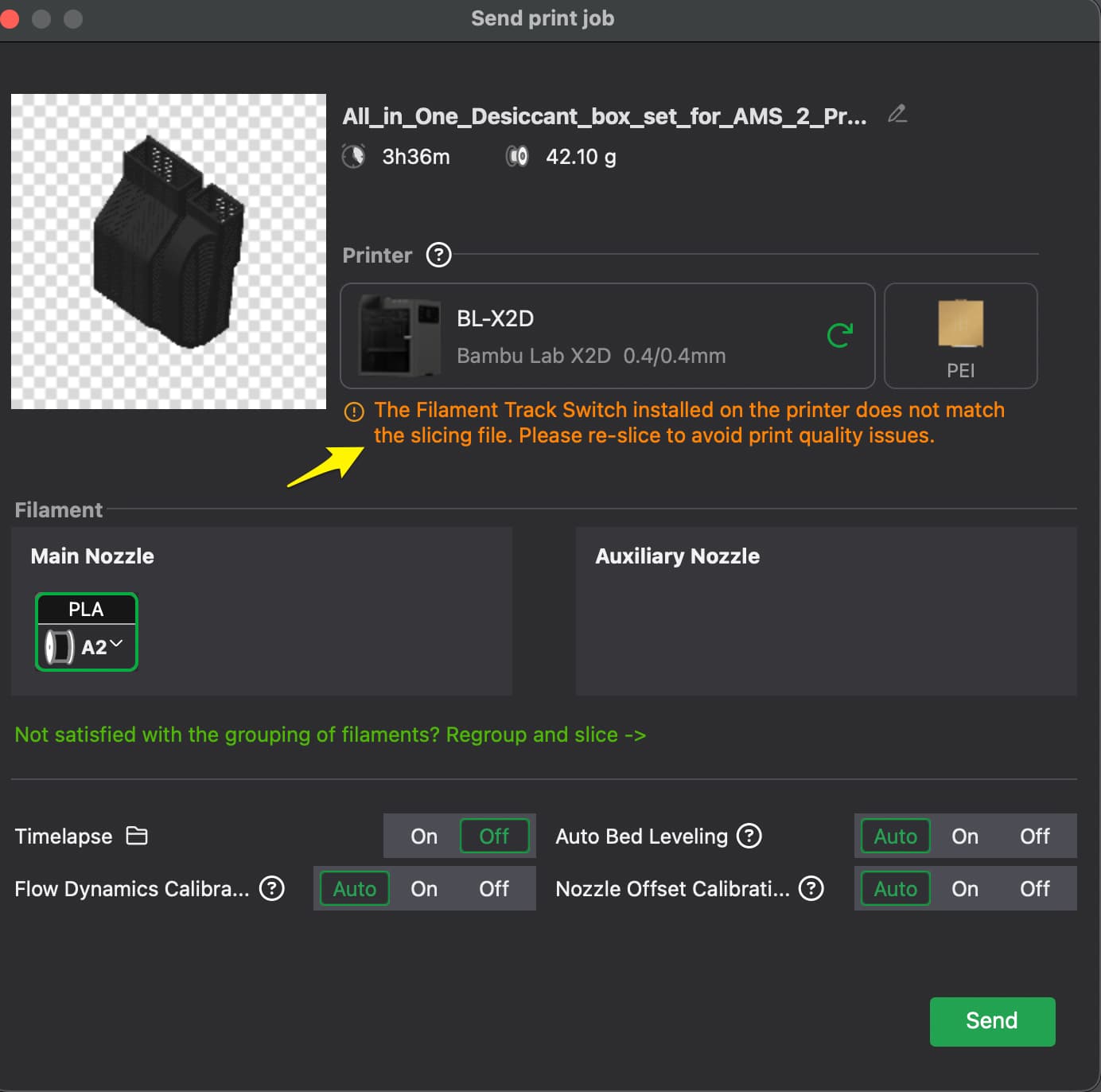

Same here, there are no special steps taken here. Just slice any file and hit ‘Print” and this message shows up (screenshots above) before sending it off to the X2D.
Same for me. Independent if it’s a download file from makerworld or own made. Everytime you send any print to the printer via Bambu Studio you get this warning.

First print and the message showed up. The file was from Maker world. I have my two AMS 2 daisy chained in the right port on the buffer and the fan in the left port of the buffer.
