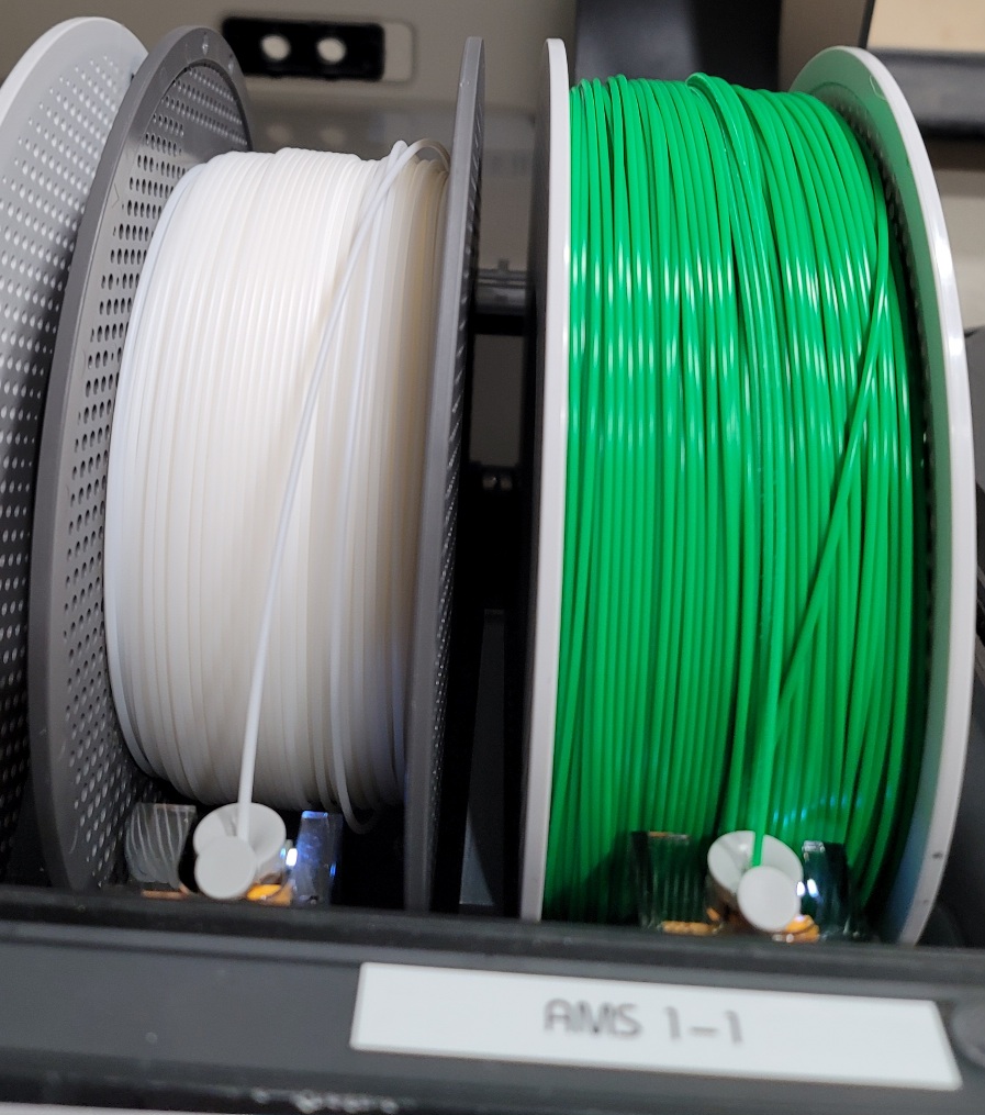

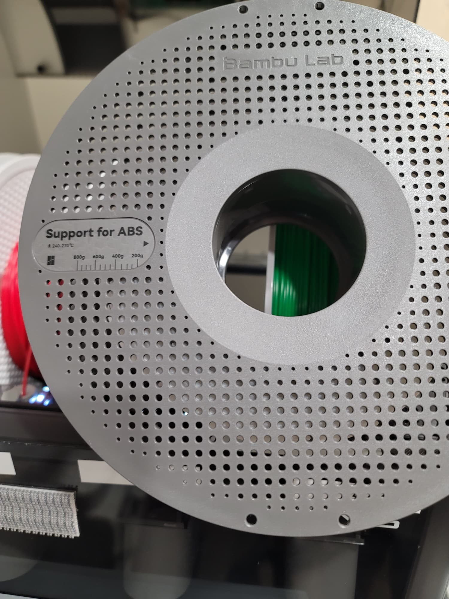

BL sells a .5kg spool of what they call “Support for ABS” which I just loaded into one of my AMS and am gearing up to try. I made it a link to send anyone who clicks on it to the wiki page. Of note is that the spool that .5kg is wound up on appears to be a regular sized BL spool. I had sort of thought about your comment about a spool of HIPS will last a long time and so it sort of makes sense that BL would sell it in smaller quantities. The white is a brand new, right out of the vacuum bag .5kg spool. The green is BL ABS and is new minus maybe a meter used off it.
To go to your point about HIPS, here is how BL describe their product.
The main component of Support for ABS is High Impact Polystyrene (HIPS). It is not sensitive to moisture and does not easily absorb water from the air, so it usually does not require drying before printing.
