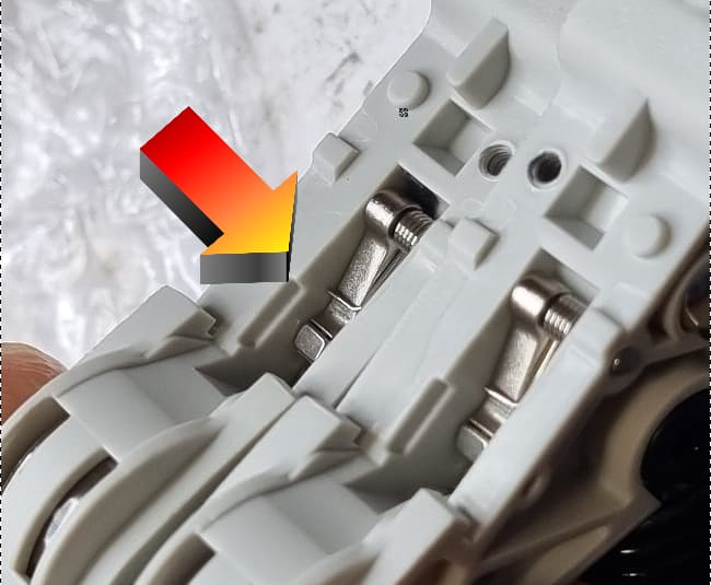

On my H2D printer I have a persistent problem with unloading filament in the right nozzle. At the beginning it occurred only occasionally, but not it stays on.
As my ticket is open since 5 days no without reply I’m trying to seek some help here.
What I’ve done:
  • Checked the whole filament part for pieces or tiny remains of filament - nothing found
  • Took out the nozzles and pulled out the tubes, pushed a piece of filament though the print head - no issues
  • Dismantled the printhead up to the idler arms - found nothing
the only thing that was strange was a tiny lever with a magnet on it in the idler arm. In comparison the magnet on the faulty arm was much closer to the sensor than in the other.
As I could not really bend the metal lower (looks like a cast metal part), I’ve tried it with force and was able to move it down a little. Not that much I would like to have it, but different as before.
I put the whole printhead back together again. Who’s ever had the “fun” to to this knows that this is nothing you want to do again.
And what sould I say, error is still there :nauseated_face:
Then I thought it was time to do a factory reset - maybe this would help. Surprise, surprise, a factory reset is not possible when filament is loaded.
What’s really strange is that I can load filament into the right nozzle after performing a power cycle. The unload process works, but after I’ve completely removed the filament, the printer says I should pull the filament back and remains in the unload function.
So, does anyone have experience with that or any hints on what I can do next?

Bambulab has now replied after a long wait of 4 days, and they offered me to send a replacement (filament idlers ). This spare part has the filament hall sensors already pre-installed. Hope this will fix the issue. I will report this here. Maybe this could be helpful for people having the same issues in the future.
Sorry, don’t know why some words are marked in bold here …
As promised here an update on this error I had. Maybe this could help users that may have this issue in the future.
I’ve got the replacement yesterday. Today I’ve installed it into the tool head. The replacement contained both extruder arms with installed sensors.
After I’ve installed it the problem was fixed. Very likely it has been a fault with the hall sensor on the right extruder arm.
So all has come to a good ending. Support was not that fast but there were no endless discussions please try this and that, make a video and so on and they sent me the required spare directly.
