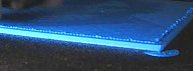

E.g, my first run yesterday, there was zero adhesion on the first layer, but lots of adhesion around the nozzle.
  • I’d put the filament in a drier for 3 hours and had it connected via the external feed not AMS, with AMS disconnected, but Bambu studio proceeded as though it was using AMS filament 1.
    – Wrong filament selection: AMS when no AMS connected,
    – Wrong filament setting: The filament was PETG not the PLA,
  • Dust/smoke (live near LA) build up had soiled the print bed, so still no adhesion once the settings were correct,
  • Filament had gotten very damp, lots of build-up around the nozzle, which caused defects in surfaces once adhesion was achieved,
  • Ugly stippling effect pattern at edges e.g where an inner surface meets a wall, with bumps that raised about .05-.1mm above the layer, causing an ugly line on the inside and outside of the wall.
    – flow rate, maybe, or settling in the filament after drying? or insufficient drying?
I’d really like to see some quick-to-run prints that would pick up on some of the basics: adhesion, stringing, wetness, etc.
