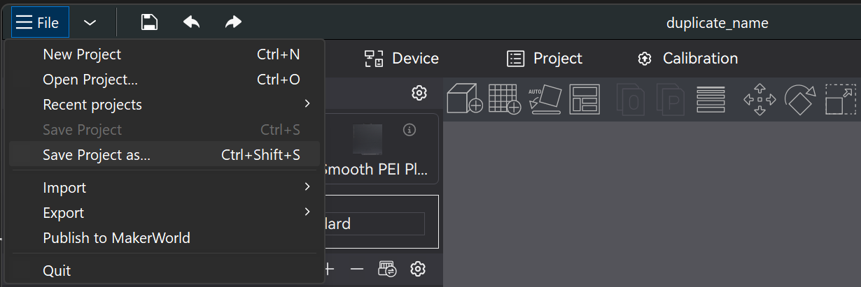

File name sent to printer. P1S
I downloaded files from Makersworld and it had 2 different models but when I printed them they both had the same file name. I had planned on printing them out of cache but continually had to resend from Studio. I tried renaming the plate but nothing changed. How can I change the file name. I also tried editing the name when sending. Nothing changed. Thanks
hI @shags72
Welcome to the forum.
If you´re using Studio, it is easy.
You need to save one of the models with a different name, before send it.
File --> Save Project as..
replace the file <duplicate_name> with a <new name>.
And it is done.
When you send it to the printer cache, it goes with “new_name” instead of the “duplicate_name”.
