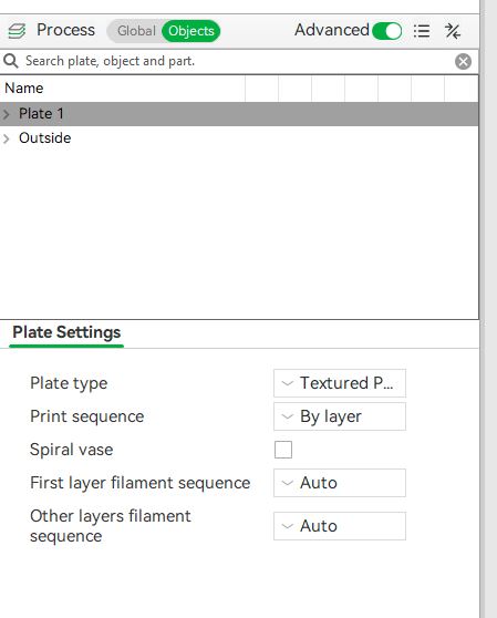

Bambu Studio used to fill up the plate very full, not it is not even filling 50% of the bed.

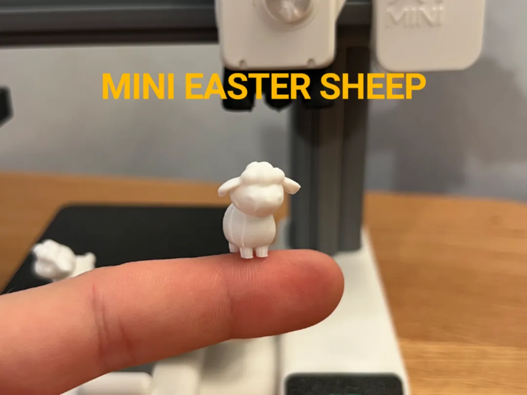

Here is a picture of a small sheep

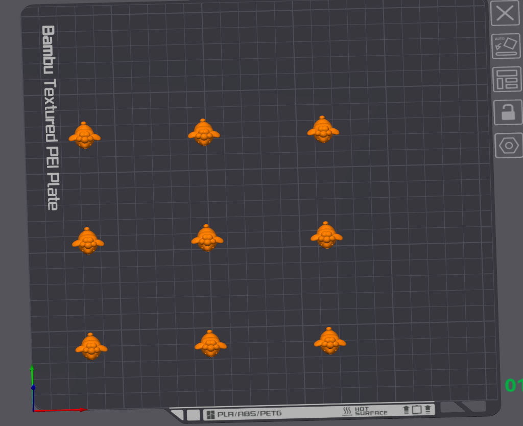

I told bamu studio to fill the bed with copies.
This is what I got. By object is NOT on.

It’s weird, what I got too, on a P1S plate and H2S plate. I’ve been using that for the past 2 days and it’s done a fairly good job of filling the bed.
Try down loading the STL.
Or uncheck “enable supports”
Thanks. Disabling supports did fix it.
