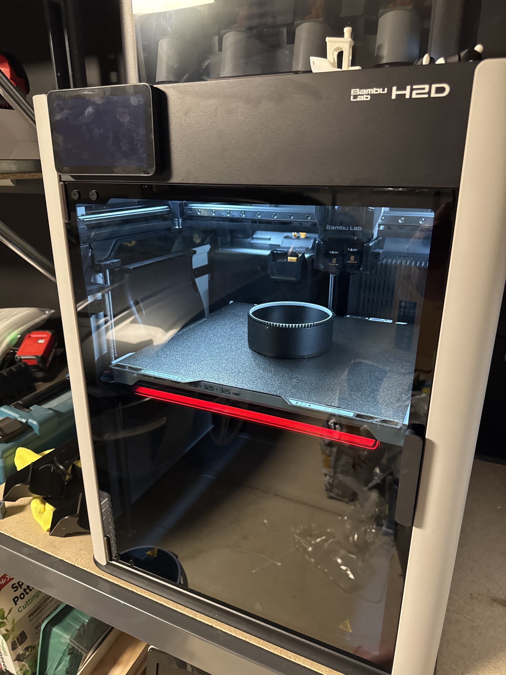

So on my fourth print, I tried a large dual colour vase 15hr print. Started it at 11pm to run overnight. Woke up to an offline printer in Bambu Handy. Went to investigate and found the printer had stopped with the led bar flashing red. Print made it about 3-4hrs in. The screen was blank and would not respond. Ended up power cycling the printer to get it back working.
Came back to my computer, had left bambu studio open, so it captured this error message of uncertified AMS detected.
The black filament is external and the white is in the AMS, so it failed soon after laying a few layers from the AMS.
uncertified
Printer is on v01.01.00.00
AMS2 Pro is on v02.00.19.47
Try enabling “skip AMS blacklist check” in preferences.
That is just a slicer setting to stop you putting soft TPU or abrasive filaments in the AMS. The fact the screen stopped responding to touch tells me it a bug.
