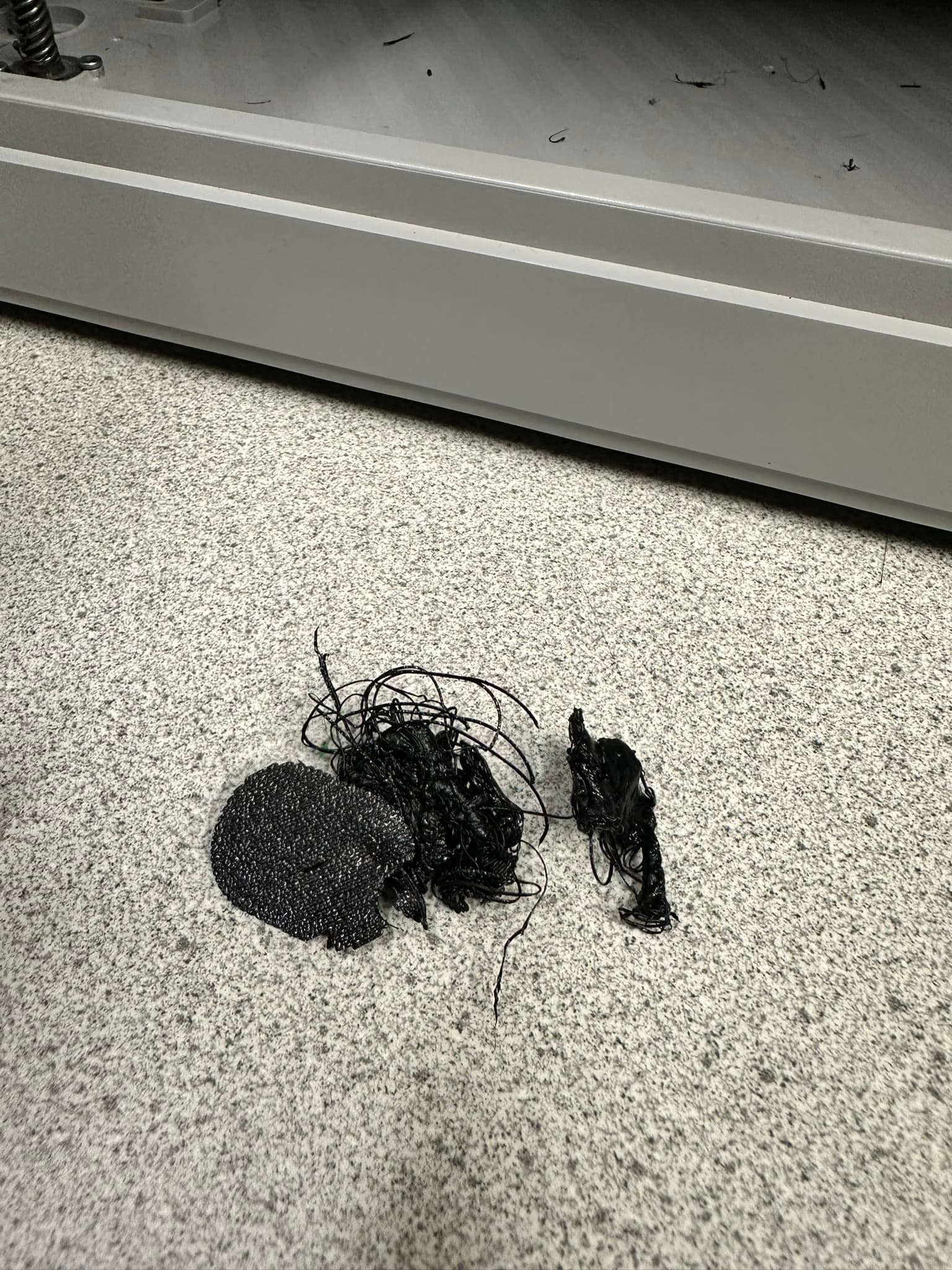

Hi everyone,
I’ve been having trouble with the first layer on my X1C recently—it just doesn’t stick to the bed anymore, even though everything was working fine before.
I’m using it since 2 months, without major issue.
About a week ago, I had a major blob of filament form under the nozzle. Nothing was laid down on the build plate, but a big blob accumulated and eventually pushed into the front cover, causing it to detach. I replaced the nozzle afterward, but I’m not sure if that incident is related to my current first layer issues.
I also update the FW, and not sure but perhaps it was just before my first layer issue.
Then I also reset to factory settings. Still the issue (see pictures).
Any ideas on what to check or try?
Thanks a lot!
Philippe
Hi there. What filament are you using? If non-bambu filament, what filament profile are you using? Have you dried your filament? More importantly, when was the last time you cleaned your build plate? How did you clean it?

I clean the build plate every week (I print every day almost 14h per day). And I also clean it just before the last test I made (the one of the pictures sent).
I cleaned it with a simple dish soap with a clean sponge.

Going from the pictures and the fact you’re using PETG I’m reminded of several things. Z starts to lose accuracy over time, check your grommet at the top of Z rods, eventually they start to wobble slightly back and forth from what I’ve seen.
PETG also usually ends in nozzle-blobs because PETG can’t be smeared, it has to be laid/plopped down. Add G29.1 Z0.03 to the end of your machine start code. This helps the nozzle avoid collecting wisps which result in the above. It seems random but it’s not.
And this will help, it’s the reason I made it. Kungpaoshizi Bambu X1 Carbon P1P Nozzle Wiper by kungpaoshiziMakerWorld: Download Free 3D Models
Otherwise with PEI it does lose it’s adhesion properties over time, so be sure to clean with soap and water, use gluestick, and if it’s old enough, wash it then use some steel wool or brillo pad to very lightly polish the plate, don’t push too hard we’re not trying to gouge it, just very slightly scuff it up to expose new pei.
Judging by the pics though I would say the Z offset is the issue. I’ve been waiting since release for them to add the offset by default but not all PETG seems to have the issue just the majority. (I’m sure it’s a formulation thing)
Oh, and when in doubt, run calibration, sure it takes 10-20 minutes, but just be happy you have an advanced machine now, and that 10-20 minutes used to take several hours doing it by hand back in the day which was such a terrible headache, now we have clearly been replaced by machines… :slight_smile:

I made differents tests. After them what is working are : I carefully clean carefully, increase the bed temperature and also the hotend temperature, and increase the dryer temperature for the filament.
The result is as it was before, but with some lines (like elephant foot) at some places where the section change.
So I need to test different temperature to adjust that I guess. I will also recalibrate again.

Hey all, I found this thread while looking for resolutions to my own “tearing” issues with Bambu PetG-HF on my X1C. Looked just about like the images at the start of this thread. In the meantime, I think I found a solution, it’s kinda embarrassing but I thought I’d share just in case. Basically: I cleaned the PEI plate. No wait, don’t laugh! I had cleaned it before (almost every print actually) to just really be anal about oil from fingers etc. But I was using rubbing alcohol on it, which I figured was better than soap and water. It’s not. Turns out that ethanol does dissolve oils…but not all oils. It’s just not all that effective…and often might just be spreading the oils around, i.e., when the alcohol dries. And I hypothesize that this is what was getting me: although my prints as a whole were (generally, not always) adhering ok to the plate, I’d have all this first layer tearing. And sometimes bad adhesion, especially for smaller parts…or the dangling end of something would peel up. And of course, once it’s “up” just a little, the nozzle hits it, tears more, more blobs, terminating is horrible badness. I had also cleaned with soap and water in the past (like I said, thought alcohol was an “upgrade” on that), but with mixed results. This time I did it right: warm water in sink, use dish soap. Start with a rough kitchen sponge, then follow up with a soft fine brush (I used toothbrush) and scrub every inch…to get down into all the little valleys in the PEI. Then rinse carefully, again scrubbing with the brush to remove all soap residues. And dry with clean paper towels. This made an instant and HUGE difference: not a single tear or failed print since then. Sure, I get occasional petg blobs or strings…but now back to “harmless”.
My hypothesis is that there were, actually, little spots of skin oils spread all over the plate. But only little spots. So the first layer would not adhere in those little places…allowing it to bubble up a tiny bit…which allowed the nozzle to hit and tear it. I could see how the z-axis tweaks given here could help. And I’m also sure that they are critically needed in some cases. But I thought I’d add this comment just as something to try before tweaking gcode.
I know: I’m an idiot for not doing meticulous cleaning before. The alcohol seemed to be working great (and who doesn’t love alcohol!)…but it was likely just diluting and spreading the tiny amount of oils…until that caused problems over time. Back to printing very pretty petg for me…
