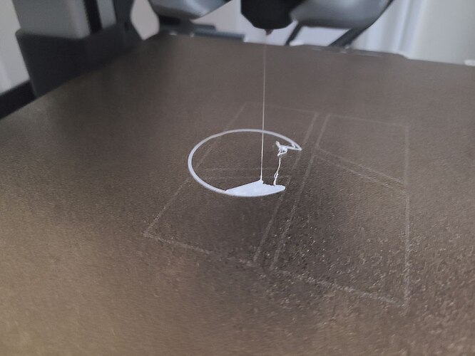

I’m still pretty new to 3D printing, i’ve printed a lot of things in the past month but I’m having random printing issues with the first layer with different filaments, I’m not entirely sure what the source of the issue is. Some prints work fine right away, some need 2-3 tries, some just won’t work, with the same filament. I tried playing with nozzle and bed temperatures in custom filament profiles, can never really make it work properly, unsure if it’s a nozzle issue or an adherence issue.

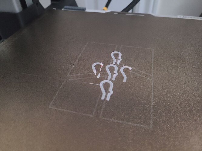

In certain cases I’ll be able to print a single model fine, but if I want to print multiples at the same time, it just goes to hell.
Pictures below, I’m using Polymaker and Polyterra PLA filament, dried in my dryer, using the default bambu profiles for Polymaker and Polyterra. Also using default printing profiles for these examples through Bambu Handy. Printing on the Bambu Textured Plate with the default 0.4 nozzle.
Any leads / ideas welcome, this is somewhat annoying.
Hi. Usually the first thing to do is clean your printers PEI sheet with soap like Dawn and hot water. It sounds like a broken record as a lot of people will tell you that but it works in most cases. Next would be to try some other filament or just use the Bambu default profile for Generic PLA. And I see some stringing so you could cool down the hot end by 5 or 10 degrees.

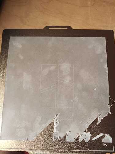

All of that actually makes a lot of sense :cry: first test cube is finished and I can clearly see my fingertips all over the plate. Thank you for the detailed description @EnoTheThracian (and yes I actually had a lot of rain in the past days)
I feel pretty dumb now, but at least I know the main problem :slight_smile: . You should have seen the way I treated the plate. It had no chance to resist, my rough, emotional disruption with the sponge. My girl standing next to me looking at the plate with jealousy in her eyes :joy:
Here is the picture: (kind of looks pretty gross)
and I can already see the results of my hard work rubbing the plates prains out.
sooo cleaaan thank you a lot :slight_smile:
