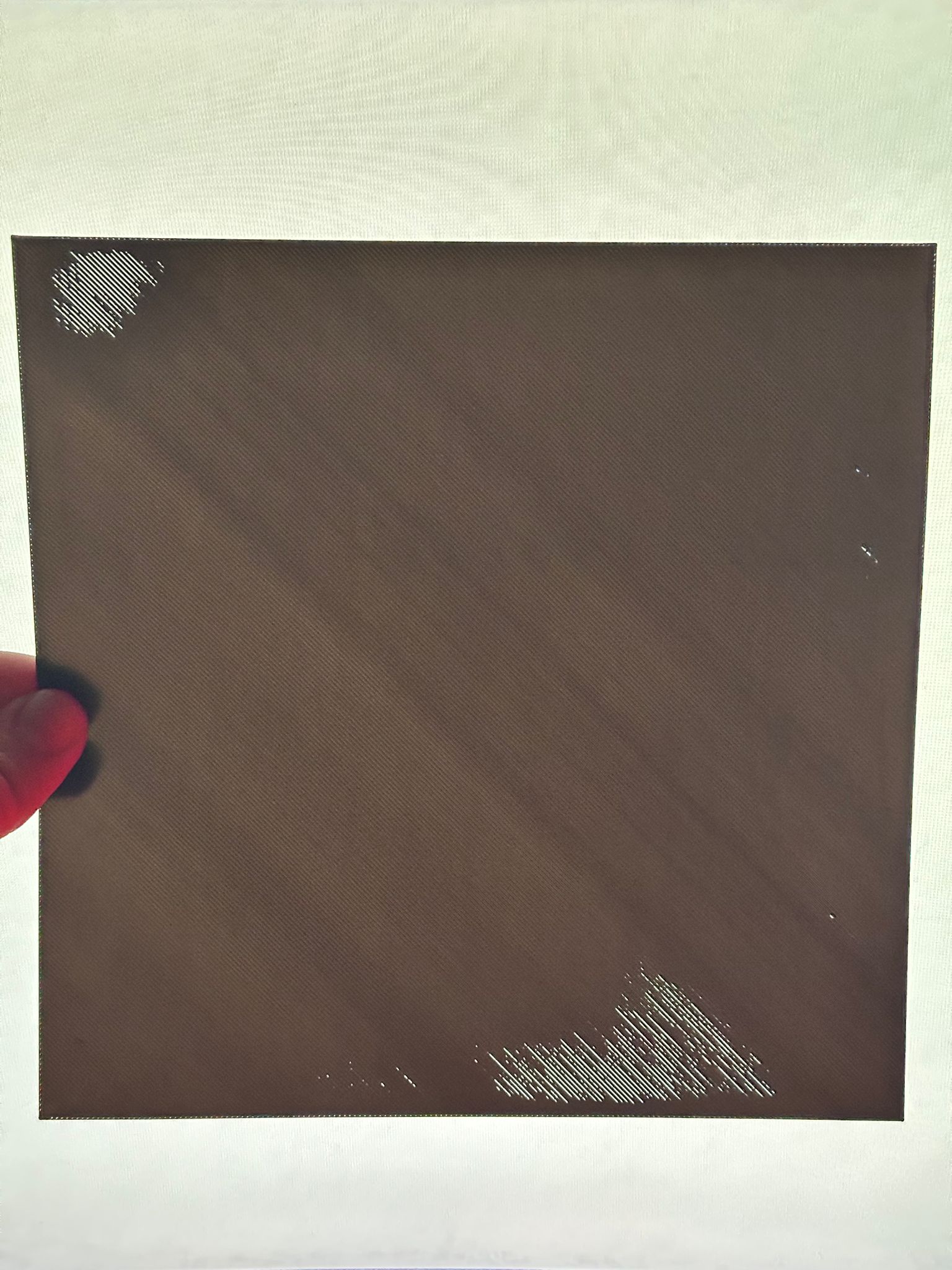

Hi, I had no problem with the first layer test before, but I changed my build plate to Bambu Smooth PEI Plate and now when I tried to print the first layer test I ended up like this:
I cleaned up my build plate with hand soap and warm water so there is no problem such as dirty or oily build plate. I think it looks like under extruded or smth. Can you guys help me?
Thanks for posting a clear image of the first layer. This doesn’t show the usual contamination you’d see on a dirty build plate, so you have ruled that out.

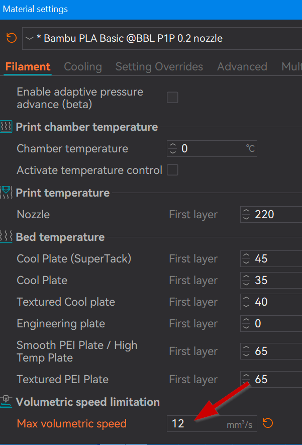

  3. If that doesn’t help, edit the filament profile and cut the max flow rate in half.
    – For example, if PLA is set to 24 mm³/s, drop it to 12 mm³/s. This forces the slicer to slow down head movement. Later you can run a max volumetric flow calibration to confirm the right setting.

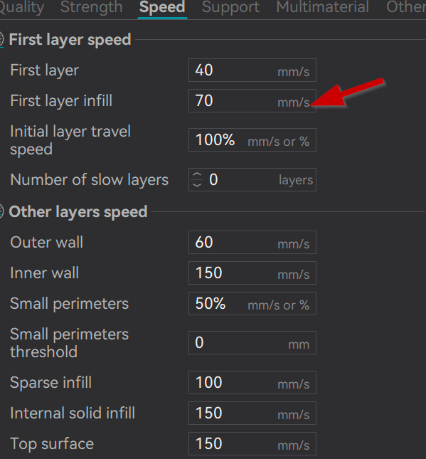

    – Increase the first-layer height in the slicer quality settings. For example, set it to 1.5 mm so you’re laying down two layers. Experiment with different heights.

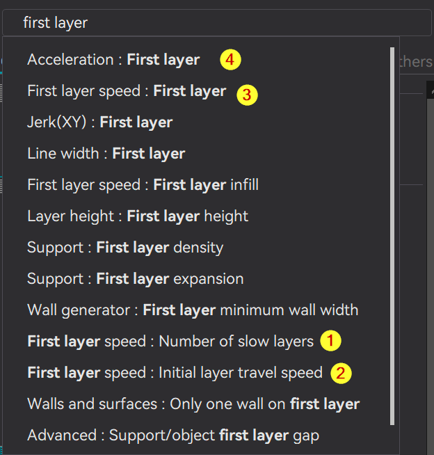

    – Since the under-extrusion is at the edges, test whether changing the first-layer speed settings makes a difference.
