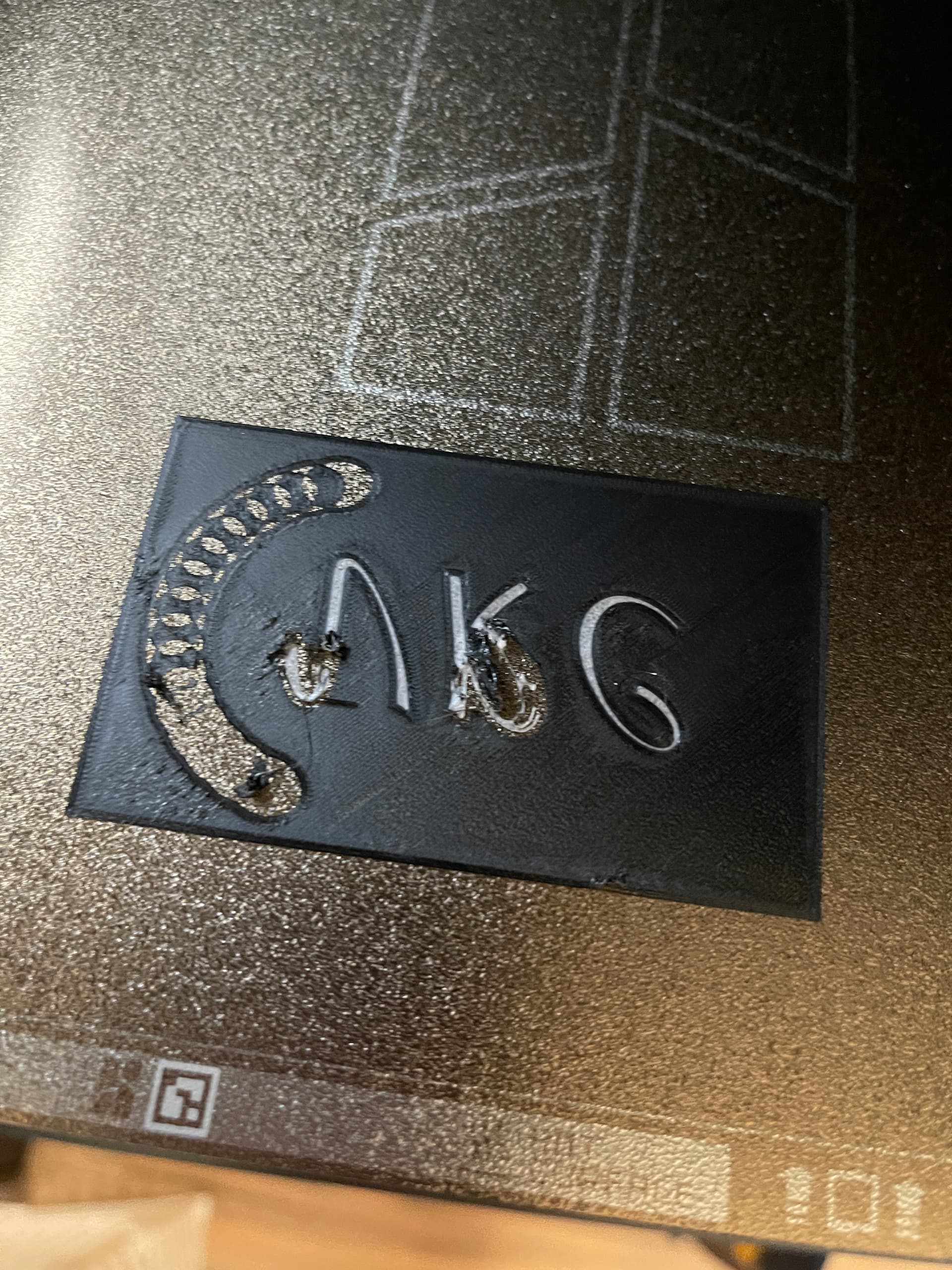

Hey everyone,
My issues from a quality perspective with Bambu have been very few and far between; of the three, one was a one-off and I still have no answer, the other was their PETG OEM filament profile wasn’t working until I tweaked it (slight increase in retraction, lowering of temps, and now I can print another material-it is great), and this third issue is the most common problem I’ve faced by far. I can’t really reconcile it with any thing I’m doing, and this is in part because often (always?) this occurs when making several copies of a single item in a given print and the others will be fine. In the attached photo, 1 of 10 had this gross stuff on the base layer, I noticed it, skipped it in Bambu Handy, and the other 9 printed fantastic. Is there anything I can do to help this? I always let my machines auto bed level (P1S) unless I’m doing 5m prototyping prints or something quick, testing related, etc. so it would’ve gone through that process. This was a ~14 hour .2mm nozzle print, Bambu .1mm standard profile, but usually print with .4mm and standard and often see it there as well. The common deonimator seems to be that this happens when there is some type of inlay/text/multicolor geometry on the base layer. Is there some process or method of setting things up to correct or mitigate this? Any thoughts/ideas?
Clean plate?
Did you try the glue stick/bottle ?
So, theory is that it is a bed adhesion issue? I’ve PM’d the machines themselves, but haven’t ever had adhesion issues (except this, if that is in fact what the root cause it), even for small parts (a jig I printed is sitting in front of me that is about 1/2" square with a hole punched out of the middle, for example). Nearly 600 hours between the two of them, about 60/40 split. Haven’t ever used a glue stick, nor have I ever washed them. Every once in a while I’ll see the slightest residue from a print after it is removed but the next print removes it, so my thought process was ‘adhesion is almost a thing of the past, the texture grips it, and the prints bring the material with them as a rule’.
Does all of that make sense? I’ll give them a wash I suppose if you think that could be it; it is the stock plate that comes with the P1S. Dawn soap and warm water, paper towel dry?

What are your plate cleaning procedures and how often?
You shouldn’t need a glue stick with PEI plate and PETG.
Wash with soap and water. Thoroughly dry the plate. And then spray with Isopropyl Alcohol (IPA). Wipe the IPA off with a micro fiber towel.
Get in the habit of wiping the plate with the IPA and MF towel between every print and you’ll have very little adhesion issues with PEI plates and PETG.

Adhesion goes down the drain through contamination.
Finger prints, smudges from handling the plate, residue from printing…
Soap or dishwashing liquid removes fat/oil based stuff to some degree but binds with dirt and grime really good.
The alcohol takes care of what the soap can’t.
