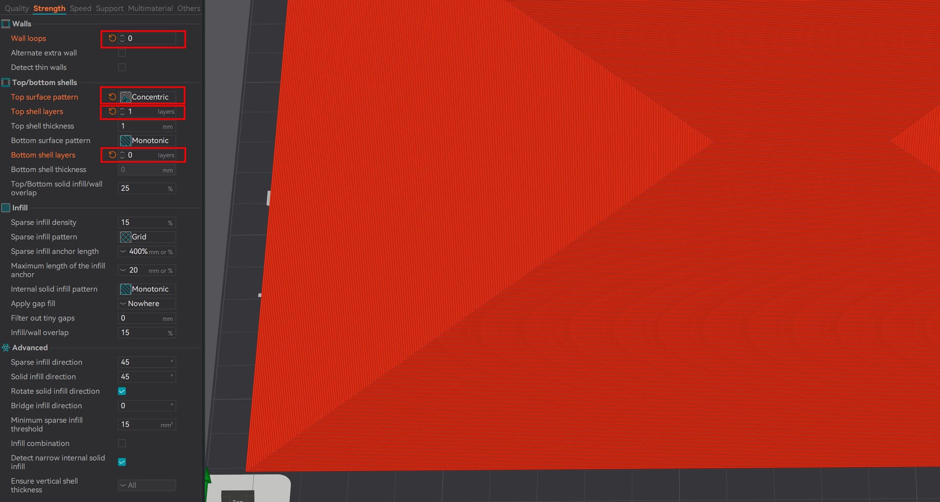

This is an excellent diagnostic technique. However, have you tried to create a single object that spans the entire print plate? The reason I ask is that often if there is let’s say a section of the build surface that is contaminated–even after cleaning–and/or let’s say the bed leveling is “off” just a smidge, a larger single first layer sheet will reveal that almost like an x-ray.
Also, try out concentric pattern instead of the default. This can produce a very homogenous flow of filament thus eliminating nozzle movement and extrusion start/stop. Think of it as like “Spiral Vase Mode” except for first layer.
Here’s how that would look. These parameters will eliminate seems and nozzle strokes caused by linear head movement.
  1. Wall Loops = 0
  2. Top Surface = Concentric
  3. Top Shell Layers = 1 (this should not be needed if you set your model height to 0.50mm)
  4. Bottom Shell Layers = 0 (This should also not be needed but it will ensure that only the top layer overrides)
Click on this twice to properly zoom in to see the layer lines.
