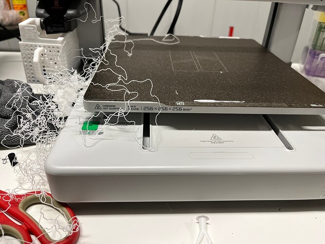

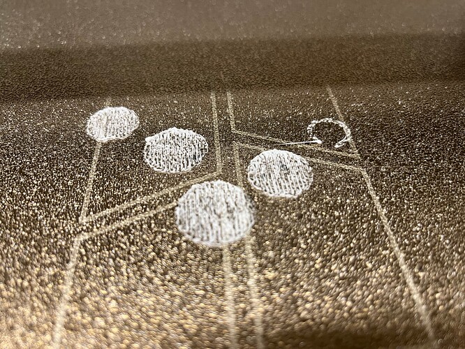

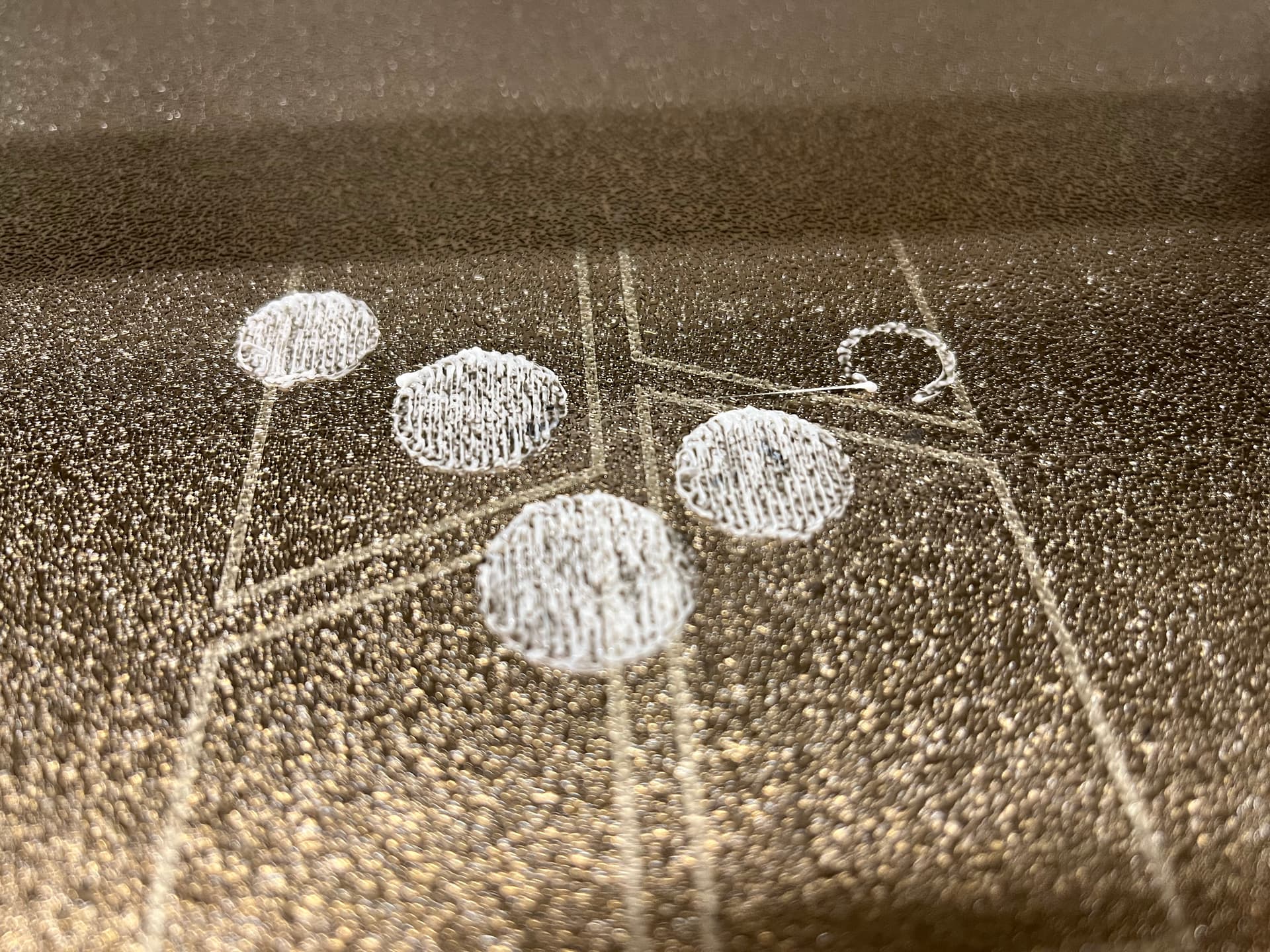

Hi all, my printer has been printing a really bad 1st layer… I’ve tried different Filaments, different nozzles, I’m not sure what’s going on. I’ve also tried widening the first layer lines. Doesn’t work. Please help :sob: :cry:
Looks like a partial nozzle clog. Try a different nozzle or
While you are at it, also check that all printhead screws are tight.
There are other possible root causes, but these neednto be eliminated first.
