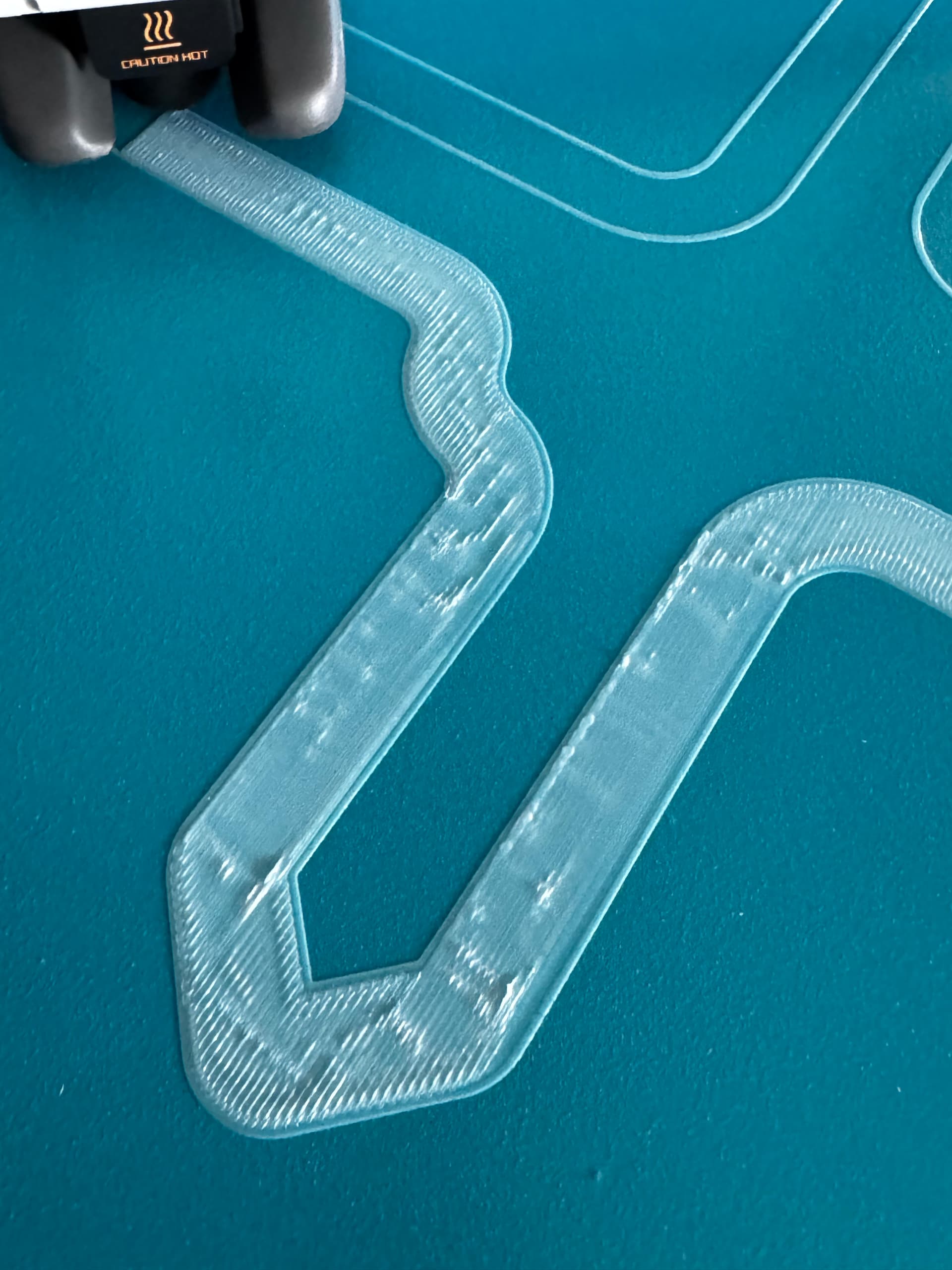

can someone tell me how to improve my first layer with this plate? Its a BiQu Frostbite.
Is this normal if you print with a new plate? I have calibrated the printer again, change Z-offset in printer settings but it looks awful! Has someone the same issues with this plates?
Did you set the plate type to smooth ?
For the textured PEI plate Bambu uses a different extrusion rate on the first layer and of course z-offset but you already corrected that…
well that comment is irrelevant… the plate is flat and even if it wouldnt !and the bed mesh is made for that. to compensate and correct the first layer ! what you see here is because he is dropping too much material and probably at a too high temperature as well
Should the plate type be set to smooth? I am using the frostbite with no issues (aside that with elegoo rapid petg i had to raise temp to 65 to get strong adhesion) but using the textured pei settings
