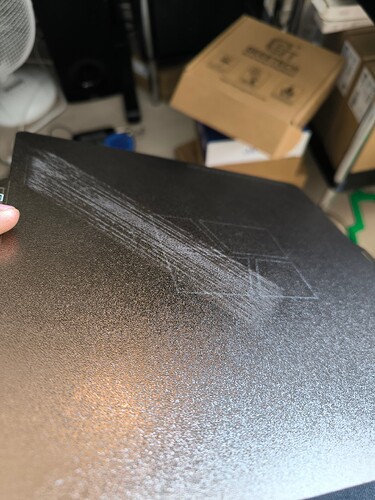

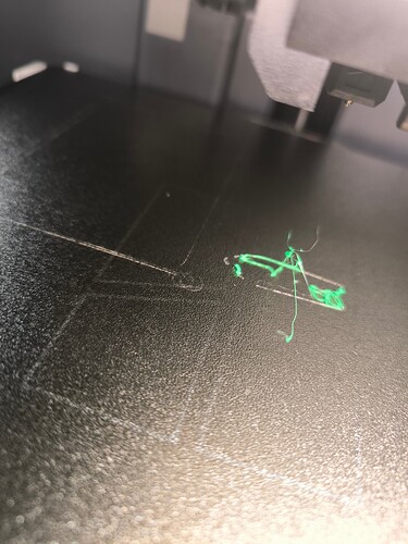

This morning I made a part without any errors, on the second piece, the nozzle ran into the tray halfway through the first layer…
calibration done, factory reset done, the head is clean-no damage, but the tray still polished it- there’s nothing under it, everything is fine, after every attempt the nozzle head still pulls the sheet. I absolutely don’t understand, I didn’t change any settings. Anyone have any ideas?

The lines on the build plate on the upper left image, are those scratches in the build plate from the nozzle or is that residue?
On that upper left picture I can’t tell if that is where it was trying to lay down the first level and the nozzle was too close to build plate or was it touching and scratched build plate and what I’m looking at is a combination of scratches and filament pushed into the textured surface?

Yes, the build plate, I didn’t do anything. The first part is finished, and with the second, boom. The scratches on a larger part were caused during the first layer. Yes, those scratches are all the nozzle, there is no material on it, it’s too close. No modding, everything is original. I’ve already tried calibration (10 times already), factory reset, another part, it doesn’t matter what I start. I don’t even understand how the nozzle can be lower ~ 1mm after leveling and calibration. I checked it, all the axles, screws are in place, nothing is hanging, everything is stable, clean. The machine is 2 months old. Yes, it’s about as if I had calibrated without the build plate and then quickly put it in, but no.
