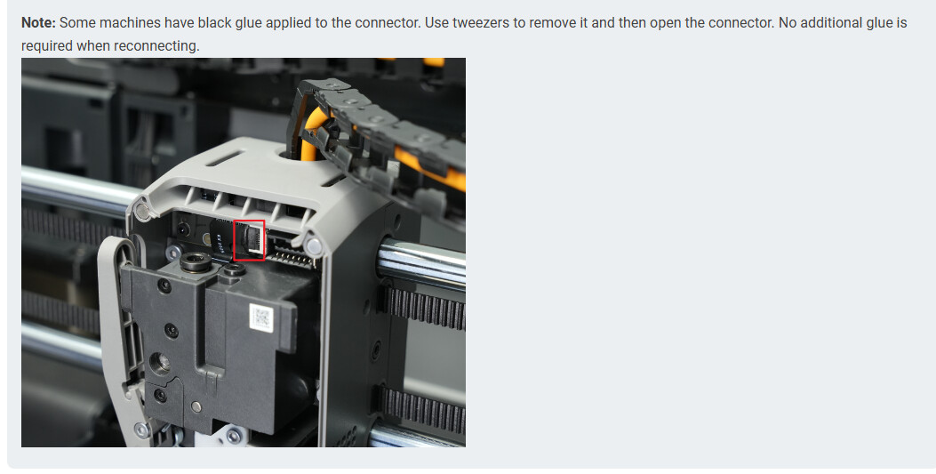

Printed my first PETG print today and the extruder got completely jammed.
Followed the guide to disassemble Extruder Components Replacement Guide for the P2S | Bambu Lab Wiki
Unfortunately the ribbon cable for the filament sensor is glued in place!!!
So you can’t disconnect it easily.
I unscrewed it from the extruder assembly and left it dangling by the cable whilst I went and stripped the extruder assembly down and cleared the clog
Put it all back together but the printer is now permanently telling me to remove the filament from the spool holder, and showing in Bambu Studio as having filament loaded
The extruder and filament sensor are completely clear.
I unpicked the glue which took ages and is virtually impossible without further damaging the ribbon cable, checked the inside is empty, checked everything works as it should, reassembled - still permanently says there is filament loaded
Had to pay £16 for a replacement sensor and gonna have to wait 3-5 days, which is great because I have a small ebay business and now won’t be able to print any orders.
I don’t know why the ribbon cable is glued in place, maybe for extra shipping protection, but it’s not mentioned on the guide - so if/when you need to clear an extruder clog I’ll warn you that you WILL be swearing! A lot!

If they’re doing the same as the P1S as far as securing the extruder it’s a fine double sided tape that is on the back of the ribbon cable. If you ever replace one you’ve seen it.
That or the silicone glue. Neither should harm the ribbon if moved carefully.
It’s the hot glue stuff that they use on electrical connectors - but it’s directly across the tab that you lift up to release the connector
That means when you need to remove the extruder to clear a clog you can’t remove the ribbon cable
I like the fact that they do it to stop things rattling loose, but extruder clogs should be fixable without leaving the filament sensor dangling from a delicate ribbon cable.
The glue was almost impossible to remove without damaing the cable
Obviously it’s just my opinion but none of the hotend components on the P1S were glued, the cables were easy to remove. At least the online guide should explain.

I agree, it can be difficult. It’s also near impossible to redo. I would guess the replacement will have a backing you need to remove if you wish to stick it down. It’ll be up to you to stick it down. I don’t know about the P2S but there’s little reason to stress it on the P1S. Just remember when you access it again.
Can’t speak to most of it, but the hot glue on connectors is kinda normal for a wide range of electronics. Use flush cut clippers as pliers, rotate your hand when gripped to peel/lever it off. Spritz of isopropyl if you are feeling brave about what’s near it.

Happy to say the instructions got updated
Now specifically state that you may have to remove glue on some models. I suspect they’ve stopped gluing this on later printers :slight_smile:
