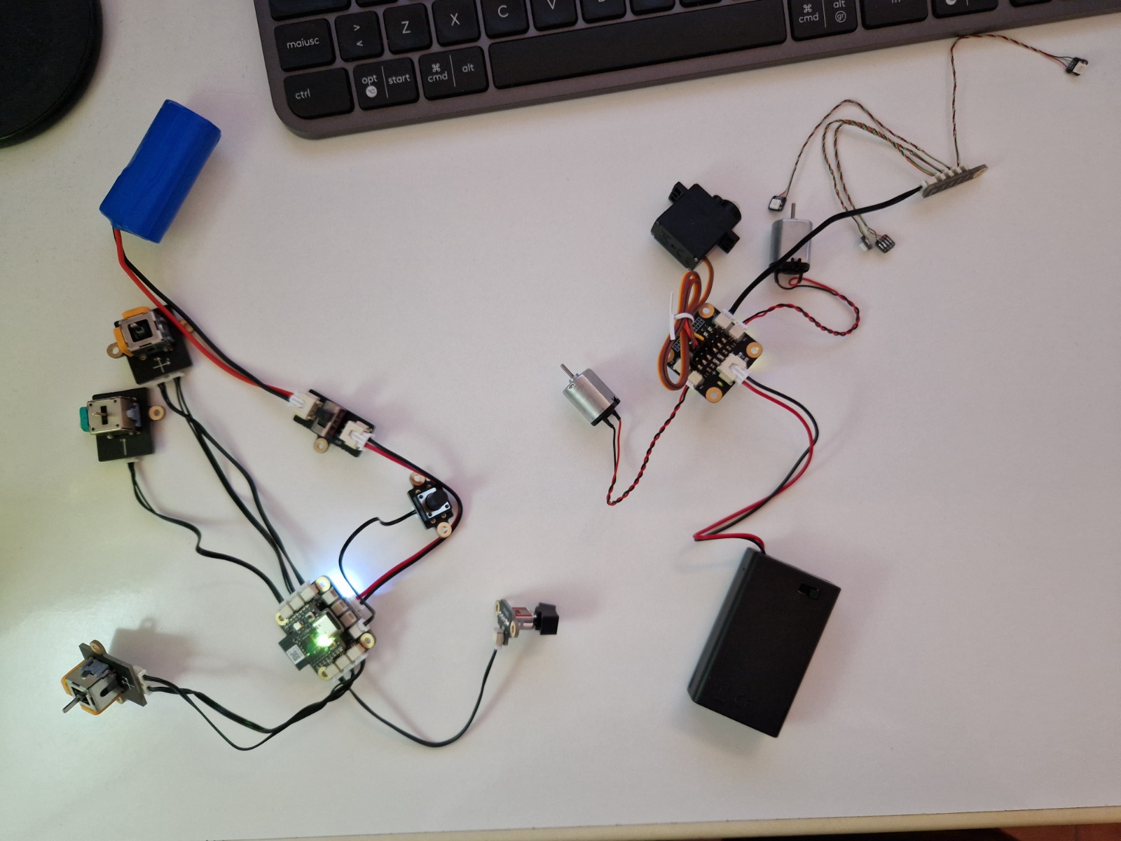

i new in this world, i have a beginner kit and for now i just want to make a test like a workbench.
As you can see in the picture i have connect all and downalod the Lunar Rover project.
  • I have configured on the PC but also on the phone
  • I have send the config to the controller
  • I have turn off and then tum on
  • I have paired the two devices
    Nothing happens! Nothing works…
Hello - I would suggest trying swapping your power sources as a test. Try using the AAA pack on the controller portion and the rechargeable battery on the receiver. I think the controller supports either power source but there can be issues using the AAA for the receiver.
Thank you so much!
Solved… Thank you :wink:
