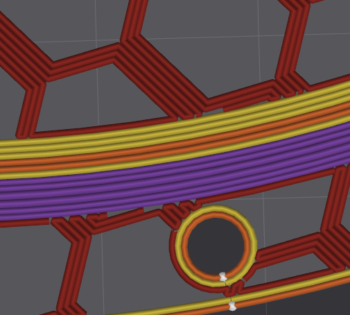

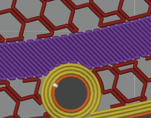

Increasing wall count only works if there is room for more walls, and the wall is the weak point. The grid of most models I see on Makerworld is actually sparse infill, created with one or two lines of filament between cells, and just a single line attaching the grid to the rim. Increasing wall loops will not change this.
This .3mf specified two wall loops, I increased it to four with no change in the grid or its attachment:
OrcaSlicer does have a Multiline setting for sparse infill which might increase strength ( with smaller openings) if chamber temperature is not the main issue.
