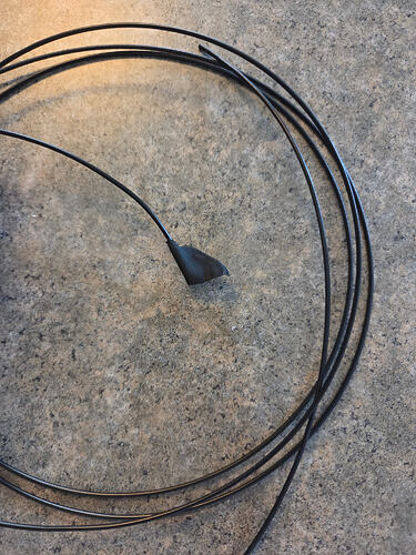

I am very upset with @BambuLab ABS filament I bought as a newbie printer. The ABS had two ends, each end was spun on the spool in a different direction. As a never before printer owner I had no idea if this was normal so I just picked an end and loaded it into my AMS Pro. I just started my first print and at 41% in 6he machine was making all kinds of noises. It had a filament load issue. The ABS spool was unwound inside the AMS. I paused, pulled out the filament and found a piece of black tape on the end. My guess the black tape was supposed to be the real end but something cut the filament when on the spool producing two more “fake” ends (yes it was factory sealed when I unboxed the filament). I am hoping this didnt ruin my AMS! Anyway, I rewound the spool back up, stuck in the loose end and resumed. So much for filament quality control! Kudos to Bambu printer for resuming the print in a failure, but I might be looking into other filament vendors.
It is a shame when the filament end isn’t properly secured to the reel. And black tape? Most companies double-secure the end by running it through two holes in the spool and bending the end. Sure one has to cut off about 3 inches of filament (or try to straighten it out)… but it works.
You’ll find however that there are other companies out there who wind reels incorrectly and they jam during print. I recently had to take my AMS apart to remove such a jam, and am in the process of re-working my entire Hot-End unit because the filament got stuck and BAKED inside. (Fun fun fun.) These are the negative sides of 3D printing. The positive side: when you get all your settings figured out (takes a bit and some failed prints)… and stuff suddenly starts working.
