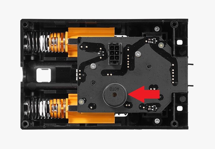

Set it off just now. Pretty loud, but I wonder where the speaker is and if we can swap it for a louder one. Anybody know where the sound comes from?

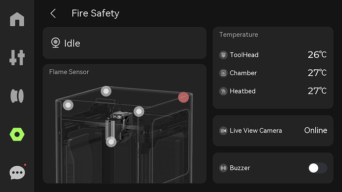

In the Settings > Toolbox > Fire Safety menu you can “Test” the buzzer which might be helpful to find where it is.
There is a buzzer on the back of the filament buffer board.

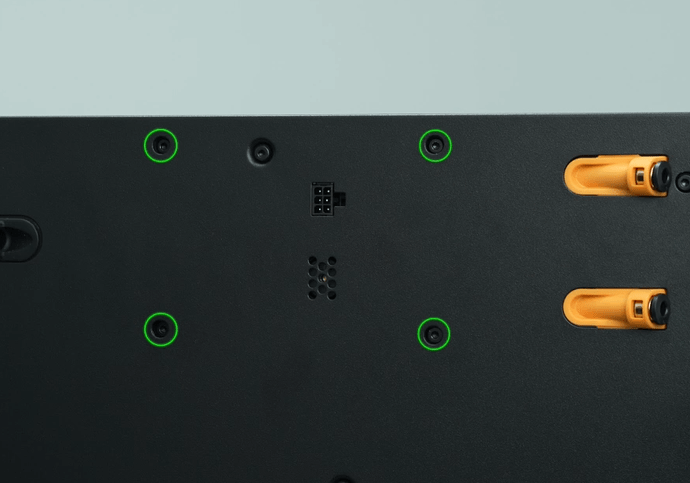

There is a grouping of holes below the 6 pin connector on the back to allow the sound out.
Thanks for the help Jon. I would have never guessed the buzzer was there.
